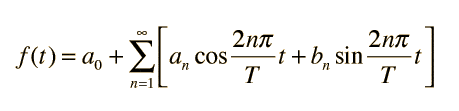

Thanks, I checked out that link and it seemed to make sense. It showed, like many other websites, the Fourier series:
I've seen this, and I've seen the integrals representing the coefficients, but I can't find where it comes from anywhere. How is this formula derived? Where would I start to derive it?

The short answer is that the Fourier series comes about from the fact that cosine and sine form a complete basis for 2π-periodic functions. The integral (and Fourier transform) arises from the inner product for functions (extension of the dot product for vectors).

I'm starting to understand the original equation now, but why is there an ##a_0## but not a ##b_0## in ##f(t)##?
Edit: Never mind, there is no ##b_0## because sin(0) = 0. Not sure why I forgot that bit.
I'm looking online here and it shows the Fourier series "with period of 2L" to be the same as in the picture below:
However in this website it says that it equals ##\frac{a_0}{2}## not just ##a_0## as shown above. Why is this? In fact, what's the purpose of the parts inside of the cosine and sine functions in the above equations? Why is it ##cos(\frac{2nπ}{T}t)## and ##sin(\frac{2nπ}{T}t)##?
Edit: Clarification
The ##a_0## is divided by two so the general formula for ##a_n## works from the formula ##a_n = \frac{1}{L}\int_{-L}^L f(\theta)\cos \frac{n\pi \theta}{L} d\theta##. The first Fourier cosine coefficient is simple the average of the function over the interval, since we integrate from ##-L## to ##L## we have to divide by an extra ##2## beyond the ##L## in the formula.
In complex form you instead have coefficients ##c_n## with ##c_0 = \frac{a_0}{2}## if you really want to get rid of that ##2##.
I Believe the ##2## in your ##\sin## and ##\cos## shouldn't be there. I couldn't find them there in your link either. You want a function that repeats itself every interval of ##2L## and that is true for ##\sin## and ##\cos## with the argument ##n\pi t/L##.

Sorry, I'm still not quite understanding what the formula is saying. As far as ##\frac{a_0}{2}## goes, I'm still confused. In the general formula ##a_n = \frac{1}{L}\int_{-L}^L f(\theta)\cos \frac{n\pi \theta}{L} d\theta## if you solved for the first term it would be ##a_0 = \frac{1}{L}\int_{-L}^L f(\theta)d\theta = \frac{1}{L}[f'(\theta)]^L_{-L}##, so why do you need to divide it by 2?
I've realized now that the ##\frac{nπt}{L}## is really just ##\frac{2πnt}{2L}##. So I realize that this shows that it's going through 2π every 2L. ##t## is in there since it is a function of time (t), so then why is there the n in there? I realize that Fourier series probably wouldn't work without the n inside of the trig functions, but what purpose does it serve? Does it have to do with the derivation of the Fourier series?
That ##f'(\theta)## is wrong.
But never mind, and don't bother for now about the ##2## in ##\frac{a_0}{2}##.
If you want to learn about Fourier series, mathworld.wolfram.com explains the very basics quite well.
Essentially, it is a way to represent any sufficiently nice periodic function over the interval ##[-L,+L]## as an (infinite) sum of sines and cosines, and more precisely of the functions ##\cos(\frac{n\pi t}{L})## and ##\sin(\frac{n\pi t}{L})## (with ##n \in \mathbb N)##.
You need all these functions because together they are sufficient to "represent" all nice periodic functions. Not every Fourier series will contain all these functions, but you need them all to represent all nice periodic functions.
Of course, you get it that when I write "nice", this will get a mathematical definition once you learn the theory in more depth. But for starters, that is not the essence.
The essence is that a periodic function can be decomposed into an (infinite) sum of elementary sine and cosine waves.

The ##n## is there because it is a series. we sum together ##c_0 + a_1cos(\pi \theta/ L) + b_1\sin (\pi \theta/ L) + a_2 \cos(2 \pi x/l) + b_2 \sin (2\pi \theta /L) + \dots ## hoping that it converges to the function we're expanding as a Fourier series.
If you take only the first terms ##c_0 + a_1\cos (\pi \theta/ L) + b_1\sin (\pi \theta)## you get a good approximation to the function (compare it to taylor series!). As to why you take exactly "integers" of cos and sine comes back to that they're form an orthogonal basis in ##L^2##-space but you don't need to know that to apply them. (This is usually covered in a linear algebra course and repeated in a course in Fourier analysis/PDE)
The constant is needed to compensate for the average value of the function we're trying to expand. Say we have the function ##f(x) = 5+x## in the interval ##-L## to ##L##. The average value of ##f(x)## in the interval is ##5##. If we calculate that with the formula we have
##a_0 = \frac{1}{L}\int_{-L}^L (5+x)dx = 10## so we have to divide by two to get the average. I don't know how to explain it otherwise, maybe try calculate some examples and you see you have to divide the constant by ##2## to get the right function.
In complex form the Fourier series in the interval ##-L## to ##L## would be
##f(x) = \sum_{-\infty}^\infty c_ne^{in\pi x/L}## and the constant term here is indeed ##c_0 = a_0/2##.
