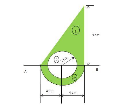

Find the Moment of inertia of the shaded region w.r.t the line AB.
##\large \frac {4R}{3π} \normalsize = 1.7 cm##
245391
Sol: ##I_{AB} = I_{AB1} + I_{AB2} - I_{AB3}##
245392
##I_{AB1} = I_{G1x} + A_{1}.Y_{2}##

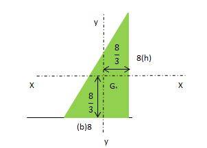

moment of inertia of a triangle,##I_{XX} = \large \frac{bh^3}{36}##
moment of inertia of a triangle,##I_{YY} = \large\frac{hb^3}{36}##
##I_{AB1} = \large \frac {8*8^{3}}{36} + (\frac {1}{2})\normalsize*8*8 (\large\frac {8}{3})^{2} \normalsize = 341.33 cm^{4}##
245395
##I_{AB2} = I_{G2x} + A_{1}.Y_{2}##
Moment of inertia of semi circle section parallel to the base, ##I_{AB2} = 0.11*R^{4}##
##I_{AB2} = 0.11*44 + (\large \frac{π*4^4}{2})^{2}\normalsize (1.7)^{2}##
##I_{AB2} = 100.79 cm^{4}##
moment of inertia of a circle w.r.t centroidal X or centroidal Y: ##\frac {π}{64}d^{4}##
245396
##I_{AB3} = I_{G2x} + A_{1}.Y^{2}##
##I_{AB3} = \large\frac{π}{64}\normalsize*4^{4}+(π*2^{2}).0##
##I_{AB3} = 12.56 cm^{4}##
##I_{AB} = I_{AB1} + I_{AB2} - I_{AB3} ##
##I_{AB} = 341.33 + 100.79 – 12.56 = 429.55 cm^{4}##
They are starting with the moment of inertia about the centroid of the semicular section, and then applying the parallel axis theorem. The centroid is located ##\frac{4R}{3\pi}## below the line AB.

In this equation, ##I_{AB1} = \large \frac {8*8^{3}}{36} + (\frac {1}{2})\normalsize*8*8 (\large\frac {8}{3})^{2} \normalsize = 341.33 cm^{4}## did they use both ##I_{XX}## and ##I_{YY}## values in it?
No. Why would they do that?
So what values have they substitute in this formulae: ##I_{G1x}##?
In all cases, they are applying the parallel axis theorem. They take the moment of inertia about the center of mass and parallel to the axis of rotation (the line AB) then add ##mD^2##.
In this equation for full circle, ##I_{AB3} = \large\frac{π}{64}\normalsize*4^{4}+(π*2^{2}).0##
Why they took zero as distance between centroid and parallel axis ? I am failing at measuring the distance between the parallel axis and centroid. .Please explain clearly. :cry:
The center of the circle is on the axis.

Why they didn't calculate ##I_{XX}## and ##I_{YY}## for each 3 sections; right angled triangle, semicircle & full circle? In this problem, ##I_{XX}## and ##I_{YY}## calculated for each given 3 sections.
When should we calculate ##I_{XX}## and ##I_{YY}## for each sections?
You have a lamina in the XY plane.
IXX is the MoI about a line through the centroid and parallel to the X axis. Likewise, IYY is about a line through the centroid and parallel to the Y axis.
For a lamina, you can find IZZ simply by adding these together. This is the perpendicular axis theorem.
In the question in this thread you are only asked for IXX, so you do not need to find IYY.
How can you tell that no need to find IYY?
You are asked to find the moment of inertia about the line AB, which is parallel to the x-axis. So all moments of inertia needed for this problem will be parallel to that axis.
So we need to neglect ##I_{YY}## and consider ##I_{XX}##?
It's not a matter of neglecting IYY. You are only asked to find the moment about AB. That is a line parallel to the X axis, so you only need to find IXX and apply the parallel axis theorem; you do not need to know IYY.
