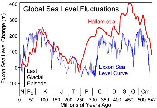

Sorry if this is a stupid question but I've searched google and I haven't found an answer. So I've been researching Antarctica and I've found a few details that don't add up. So supposedly if the ice melts on Antarctica then sea levels will rise by 200 feet - Antarctica contains 70% of Earth's fresh water.
So here's where I'm having trouble finding out information. Supposedly 65 million years ago or so (I may be wrong on the numbers, but it doesn't matter), Antarctica was a hot place that had lush forests - then suddenly it got cold and turned into the Antarctica we know and love today. So where did the water come from? If the ice on Antarctica melted, then the sea levels would rise by 200 feet...if a few million years ago, Antarctica was hot then obviously it didn't contain anywhere near the amount of water it contains now...so where did all that water come from? Were the sea levels 200 feet higher than they are now in the past? Or did water evaporate from the rest of the lands around the world before being transported to Antarctica, then frozen and dumped there? When Antarctica was hot, where was that 70% of Earth's fresh water stored?

I must be extra dumb because I've read that but it still doesn't answer my question - where was the fresh water originally? Were the sea levels 200 feet higher in the past and the ice came from the sea evaporating? Or was the world covered in much more fresh water that got redistributed and eventually fell on Antarctica as snow?
I think the simple answer to your question is, yes, the sea level was at least 200 feet higher before the antarctic ice sheet formed. Look at this graph from this Wikipedia page. 65 million years ago, sea level was about 150-200 meters higher than today
That seems likely to me. I assume the water evaporated from the sea and was deposited on land by precipitation over the course of millions of years.

Some things to consider. Only ice that is not floating on oceans would be able to raise ocean levels. As we know ice floats because it expands. Once it melts it returns to the same volume the ice displaced (why your glass doesn't overflow when it has a lot of ice in it.
The average temp in Antarctica is -10 to -60 centigrade from near the coast to the coldest place, so it would take at least 10 degrees of warming to start melting and I understand that is way below present predictions. http://www.antarctica.gov.au/about-antarctica/environment/weather.
We would also have to know the land mass created by the plates at the time of the highest ocean rise. Does anyone know how much land mass there was when the oceans rose 200 ft higher.Obviously, more land mass, higher ocean.
Finally, how much water was actually on the earth, as I understand we gradually are losing water to space, just like, but not nearly as fast as Mars did. Is that significant?
It does not really work that way. Earth's thin crust floats on the fluid mantle.
One effect is that when sea level is raised 4 metres, the added weight of water on the sea floor would push that down by about one metre, leaving a 3 metre difference on the coast. But pushing the oceans down lifts the land, which gives back more than a metre because there is more area of sea than land, so it lifts the mountains slightly. That is called isostasy.
The real problem is finding something solid to measure sea level against.
