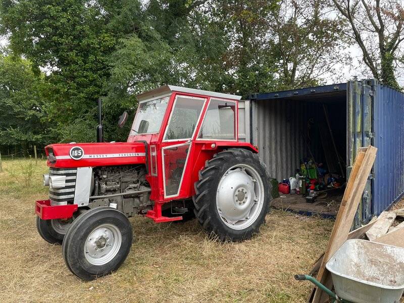

In summary, the tractor's battery is not charging. The battery and generator are working properly, but the current is not flowing properly. The troubleshooting procedure will depend on the make, model, and year of the tractor.

It’s a Massey Fergusson 1974, Mf 165 with original dynamo. Engine diesel A4 212.

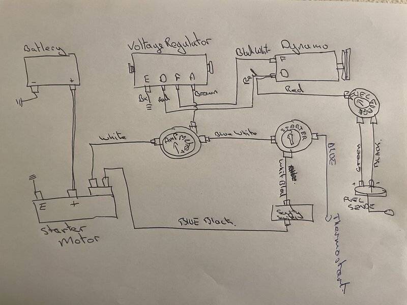

I advised a have purchased new wiring loom. This came with different colour coded wires from original spec. But does look to have all correct wires. I ve drawn the following wiring diagram if you are interested. And have got new bushes for dynamo and new regulator.
The tractor has been rewired before I got it and so I m hoping to resolve a few issues such as not charging and fuel guage not working.

I m not sure if I uploaded image so having another go

FYI I did get my battery charging. The issue was in the dynamo loosing its residue magnetic field and even when connected to a new battery via a voltage regulator it (dynamo field terminal) needed to be ‘flashed’ to enable the voltage regulator to send a variable current to modify the magnetic field in order to regulate the charge it generates. I did that early doors but could not detect much of a charge which confused me for a while. This was also hampered by my ammeter needle getting stuck after years of non use and also having a new battery that was fully charged and thus did not need charging. I started the tractor with battery and could see no charge on ammeter but a variable voltage from dynamo terminal. Voltage at ammeter at about 12v. I disconnected battery whilst still engine running.
I turned lights on and they came on with out battery.
So I knew charge was being generated. I could now see a volt meter reading of 14.n volts at ammeter but still gauge needle not showing charge. I was confident there was charge now. And after some gentle tapping and shaking the needle sprang into life. So reattached battery and now when revving engine can see charge on ammeter. So am concluding all is now working.
