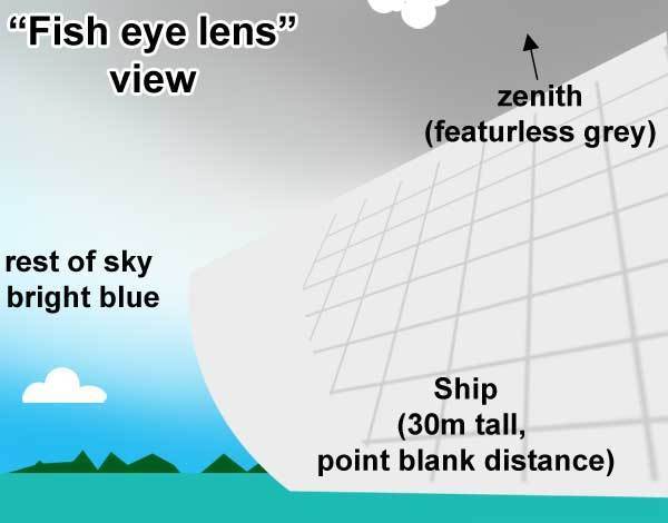

I observed a strange phenomenon the other day which led me to ask this question.
I was in Bahamas on a cruise, where it is very bright. This might have enhanced an otherwise more subtle effect.
(OK, get the drinking jokes out of your system now... :-p)
I was outside, right next to the hull of the ship on a tender. It was about 11AM, so sun was very high in a virtually cloudless sky. Yet I was so close to a 12 story structure that I was in shadow. It was clear and there was no haze.
I looked up at the sky directly above me, so I was looking through sky that was in ship-shadow into cloudless sky. The sky directly above me was so dark that I thought for a good minute that the sky was completely overcast and grey with cloud cover, like it was about to rain very heavily. Anywhere else I looked the sky was bright, saturated blue, but right above the ship it was this medium foreboding grey.
I'm pretty familiar with sky and weather phenomena, so I have a lot to compare to, but this was odd. It took me a few moments of analysis, and some small clouds to drift into the grey before I could convince myself that the sky I was seeing was actually clear as a bell like everywhere else, and not overcast.
Obviously what was happening was that I was looking at the shadow of the ship. But shadows are a lack of light, which means I should have been looking through dark at bright sky beyond. In a clear hazeless sky, I should not be able to see an absence of light.
It leads me to wonder if most of the scattering due to sunlight actually occurs very near the observer, not across the entire expanse of sky. In a sense, the implication of this is that most the brightness and blueness of a sky is actually being generated less than a 50 metres from the observer.

My ad hoc theory:
Blue light of the sky has an intensity proportional to [itex]\sin^2\phi/\cos\theta[/itex] where [itex]\phi[/itex] is an angle between your sight axis and the line pointing to the Sun and [itex]\theta[/itex] is an angle between sight axis and Zenith.
It is strongest when you look perpendicular to the line to Sun, low above horizon.
As you were in tropics looking vertically and the Sun was almost in zenith, you got the smallest possible amount of blue light of all conditions.
[itex]\sin^2\phi[/itex] - due to scattering dipolar profile
[itex]1/\cos\theta[/itex] - due to amount of air on your sight path
gray (rather than black) may come from scattering on large particles (dust, etc) in lower parts of atmosphere
That can't be true. If it would be, you would see blue light from perpendicular beams of white light: e.g. car lamps.ADDED>>>
Or... maybe I was wrong argumenting for [itex]\sin^2\phi[/itex] factor? I must rethink it... Anyway [itex]1/\cos\theta[/itex] seems to be obvious.

Yes, I am well aware of this phenom, as an artist, a photographer, a sailor and a weather enthusiast. You can see in my diagram that I've shown the sky blue near the horizon and whiter higher up.
This was distinctly different. It was darker, not lighter. And grey, not blue or white.

I considered taking some photos, but there was no way I could. I would have needed a fish-eye lens on my point-n-shoot. The phenom needed the whole sky to be seen, and that's a lot of PhotoShop stitching...

I don't need to tell you that human visual perception is highly subjective. The eye & brain are correcting the perceived luminosity and tint. Just because a part of the sky looked darker, doesn't mean it was darker. It might have looked darker in contrast to the white(?) ship hull. Just because the sky looked less saturated(blue), doesn't mean it was. The brain normalizes colors.
As for objective effects: A clear sky can be darker right above, because you look trough less atmosphere and thus see less scattered light.

I might suggest that the reason for some of this effect could be the existence of flare inside your actual eye. They are far from perfect optics - relying on a lot of image processing to get the high standard of imaging that the luckiest of us are blessed with. (Eat yer heart out Legolas) Everyone who uses a camera seriously knows about using a lens hood, even in. circs where you might not think it necessary. Under nearly all conditions, we see the sky, modified by a lot of natural flare and 'bluer' than it really is.
I think Dave's observation was there because of the lens hood, in the shape of the ship and, because this phenomenon is so rarely revealed, it appeared very extreme. The brain is very funny about some things.
I looked for some evidence. Looking through a lot of pictures in my Aperture Library, I see that the bluest of blue skies (not Caribbean) have typical values of R56, G75, B117, which shows how unsaturated a 'really blue sky' blue is. I also looked at 'really red' sunsets, finding typical values of R193, G90, B38. Also, by hunting around in areas of sunset pictures, it was very easy to find pretty much equal values of RGB (grey!).
So, it is possible to find areas of sky, in many pictures, which are actually grey - when there is an appropriate scattering away of some wavelengths and scattering towards of some others.
The only way, Dave, to be sure is to go and have another holiday and take the camera with a fisheye lens and other lenses - making sure to put the exposure on manual.

DaveC426913 said:
That is exactly what I am saying, yes.
They auto correct colour to make for a good picture, based on what camera manufacturers deem "a good picture" under average circumstances for average users. (Having studied it in college and 10+ years in the photo industry, I could go on at length about white balances and neutral greys. De-correcting for auto-colour correction was a large part of my work.)
My little point-n-shoot has at least six settings to correct for colour temp. of lighting. It's default state is auto-correct. More sophisticated cameras have more sophisticated algorithms for correcting.
Unfortunately, what you want is exactly the opposite. You want a system that does no correction at all.
Without calibration, cameras cannot be used to compare colours like you are trying to do.
Your next range of cameras can shoot in RAW, which produces larger files but allows you to get the colour balance better by picking on a portion of the picture, or in the batch, with a reliable grey.
But we are verging on the subject of what colour 'actually is'. I have to insist it's totally in the mind of the viewer but that we can measure spectrum and equivalent 'black body' temperature very accurately. Colourimetry is based solely on a consensus of subjective opinions about colour matching of different combinations of differently produced primaries.
I was thinking that the thread was simply about the relative amounts of scattering of light from different directions and with the sun in different positions. Even though the measurements are a bit flawed, the results from my camera do show what I am getting at- and that is that there are places in the sky where you might expect R, G and B signals to be much closer to equal than in other places and that nowhere will the colours you see be very pure.
Get those tickets booked and tell us about it.
  • #33
agentredlum said:
Have you ever made a pinhole camera?
I have, and i have looked through it.:smile:
Do your own eyes have correcting algorithms?
Yes they do. They are constantly correcting for the effects of the lighting on the colours of objects. If they didn't, you would see the same object at midday and at sunset and think it was a different object, because it would appear to be to different colours. The agenda they are following is not one of scientific measurement but of making the best sense of what they see of the world around.
Why should a pinhole camera make any difference to what colours you see, compared with just looking directly at a scene?
btw I saw that picture of the sun ("7)") - not sure what it was supposed to prove, though. The three 'representative' coloured objects were obviously there for some sort of reference. However, because the chromaticity values for those references weren't quoted (or even the values for the sun's surface, then the picture is no accurate evidence of anything.
The fact that the atmosphere makes a difference to the spectrum of the sun's light is very obvious, no?
  • #34
As sophie pointed out, absolutely. (Your brain that is.) In fact, our personal perception is far more heavy-handed at auto-correction than cameras.
Look around you right now. What lighting condition are you in? Tungsten? Fluorescent? Daylight? Did you actually have to think about it? Regardless of what it is, you will see it as white.
A camera (even with its auto-correcting feature) sees the difference between daylight and fluorescent so powerfully that you'll think your pix are ruined.
  • #35
One man's "heavy handed" is another man's survival fitness. Homo sapiens, way back, was far more interested in recognising, consistently, the reflected colours of meat, mates and foliage than in assessing the colour of the Sun. We still have to take the jumper outside into the street to see just how near it matches the socks, though, when we're in Marks'.
