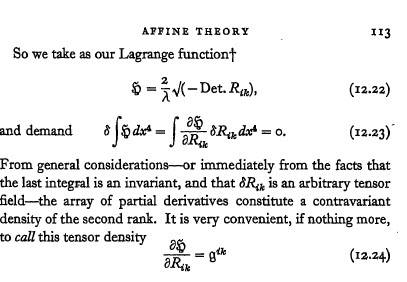

Well, can't it be, say, the determinant of the Ricci tensor? What then?
Wouldn't the theory be more than second order in derivatives, if the Lagrangian density would be the product between the sqrt of the Ricci tensor's determinant and the Ricci scalar ? My guess is yes. It's the same reason we would reject quadratic, cubic,... terms in the Ricci scalar.
Perhaps, if you have det of the Ricci tensor, you will not need the Ricci scalar anymore?
Are you suggesting that the Lagrangian density would simply be the sqrt of the Ricci tensor's determinant ? If so, then the theory wouldn't be local anymore, it would have an infinite number of derivatives. And the determinant couldn't be without the sqrt acting on it, because it wouldn't be scalar, but a scalar density of weight 2.
What is wrong with square root? You are using square root anyway. Why would the theory have an infinite number of derivatives? In fact, to take square root of the det(Ricci), you do not need metric at all. You just need a connection. One can start with a symmetric one.
True, in the most general case, the Ricci tensor (and the determinant of its matrix in a coordinate basis) can be defined independently of a metric on the manifold. So what's the Langrangian density you propose ? And what degree in the derivatives are its Euler-Lagrange equations ?

From Schrodinger's "Space-Time Structure", Cambridge University Press 1950, p. 113, Chapter on "Pure affine theory"
See also:
http://arxiv.org/abs/gr-qc/0406088"
Authors: Jerzy Kijowski, Roman Werpachowski
Abstract: Affine variational principle for General Relativity, proposed in 1978 by one of us (J.K.), is a good remedy for the non-universal properties of the standard, metric formulation, arising when the matter Lagrangian depends upon the metric derivatives. Affine version of the theory cures the standard drawback of the metric version, where the leading (second order) term of the field equations depends upon matter fields and its causal structure violates the light cone structure of the metric. Choosing the affine connection (and not the metric one) as the gravitational configuration, simplifies considerably the canonical structure of the theory and is more suitable for purposes of its quantization along the lines of Ashtekar and Lewandowski (see this http URL). We show how the affine formulation provides a simple method to handle boundary integrals in general relativity theory.
