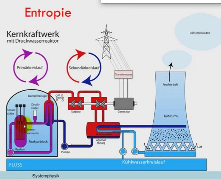

this picture being in german is till readable for readers in other languages!

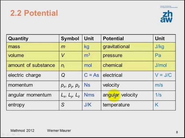

I am studying right now a variation of physics didactics called system physics and that is based on "karlsruher physics course" that uses the concept that you took as an example with the water damn to describe physics by having physical quantities embodied in a volume and of potentiality fields. Fascinating about this is, that all areas of physics, be it the classical physics, or be it quantum and relativistic physics, but also fluids, thermodynamics, chemistry and rotational and translational mechanics can be described using the same algorithmic equations and the concepts of potential energy either flowing freely from a recipient with a higher potential to a one with a lower potential releasing energy as the result of the difference of the potential energies or requiring a "pump" that pumps energy in the system. To take your example of the water damn again. A way to store energy in a public grid is to pump water from a lower reservoir to one with a higher potential energy level. Here the water pump converts electrical energy into potential water energy by transporting water volumes between the reservoirs.
I have taken the picture of the above table to show the 7 physical quantities and their related fields that result in a "potential energy level" of a reservoir! This style of teaching physics, besides the fact it allows to model problems and simulate them using tools available for "system dynamics", a concept developed by the Sloan Institute at MIT in 1956, I love the tool "Berkeley madonna" and the modeling and simulation language "Modelica" that represent powerful tools.

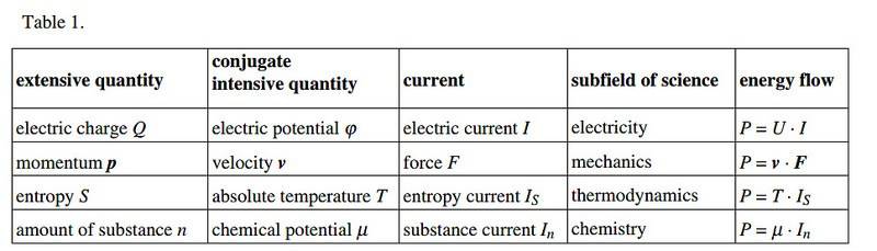

Just to wake your interest, http://www.physikdidaktik.uni-karlsruhe.de/Strategien/Analogien_englisch.html a link to a resource available at http://www.physikdidaktik.uni-karlsruhe.de/Strategien/Umwege_englisch.html website. http://www.physikdidaktik.uni-karlsruhe.de/publication/ejp/kpc_ejp.pdf the link to an interesting pdf archive and here 2 pictures that should be of interest:
This table taken from the above linked pdf archive shows how the same kind of simple algebraic equations apply to fields of physics normally seen as completely separated. if you keep in mind that physics is just a science that generates models that allow to predict and compute events observed in real or that are used to be searched for, then this view points on physics without reinventing the wheel displays similarities between the different fields of physics, just by applying the methodology used to model complex dynamic systems developed by the Sloan Institute of MIT in 1956. I found this to be very interesting perspective, as it enables me to model what i believe I have understood and verify my understanding by analyzing the results of the modeling and simulation!

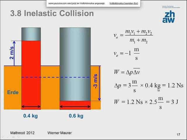

This picture shows the inelastic collision as an example shown using a fluid picture that is well suited to represent the facts using the didactics of System Physics.

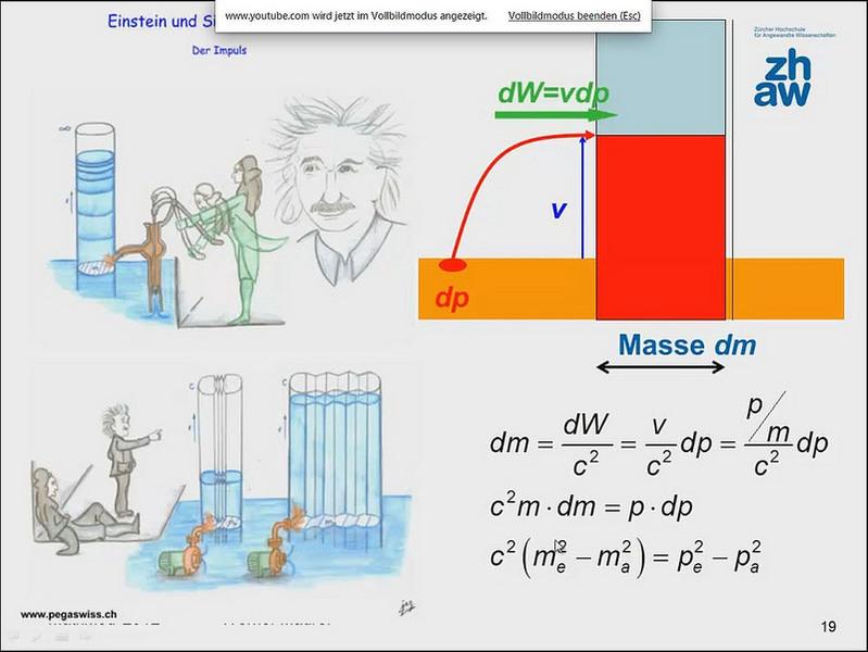

This final picture I want to add just as an appetizer to look into system physics:
I am presenting all this as it allows to look in more detail into the misconceptions presented by Cecil in this thread and at the same time offers an alternative to correctly dwelf into what Cecil and others have been trying to say. As I wrote elsewhere, try to get more into the topic before just presenting wild not organized and even less understood topics being reflected about!
