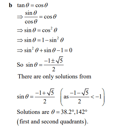

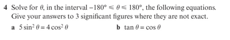

practicing some Trigonmetric identities and equations questions, and unsure how the mark scheme managed to reach what sin theta is equal to (Q 4B)
sin^2 x + cos^2 x =1
Q4B
Mark scheme
My working
NVM guys, i just realised that the quadratic formula was used! Sorry for anyone who may have wasted time
