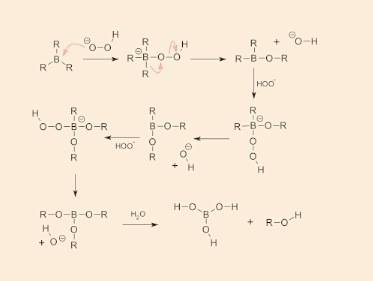

I cannot for the life of me figure out where the O-O-H comes from that got added in the
3rd step! :confused:
Here's image of the reaction mechanism:
The H2O is not used until the last step and the H2O2 has already been used (except for the H+), so the other O that adds to the OH- to form O-O-H must be coming from the NaOH when it dissociates into Na+ and OH-...
But this would not make sense because we would have an OH- and an O- adding together, and that would be too many electrons! :confused:
Thank you so much! :)
Chemistry news on Phys.org
There is more of H2O2 from where it came from.
Oh! Okay! I thought that there could only be one molecule of H2O and H2O2 and NaOH because that is what is shown on the reaction arrow.
But, I guess, that only shows what is being used...not the quantities of each...
Thank you! :)
