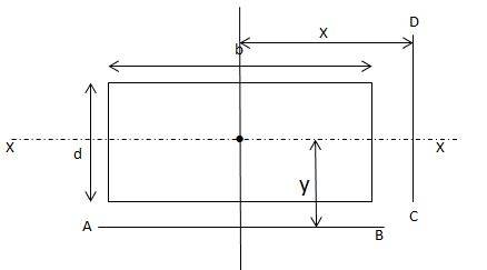

Where does the plane exist in this parallel axis theorem?

MOI of an area w.r.t any axis in its plane is equal to the MOI of the
area w.r.t a parallel centroidal axis plus the product of
area and square of the distance between the two axes.
##I_{AB} = I_{GXX} + A.(y^{2})##
245272
Same applies to CD;
##I_{CD} = I_{GYY} + A.(x^{2})##
In the above statement, "any axis in its plane" where does the plane exist in this sketch?
The area is that unlabelled rectangular figure, and it's in the plane of the page.
Is that area perpendicular to the plane or parallel to the plane?
The area is within the plane. It is that portion of the plane enclosed by four lines.
