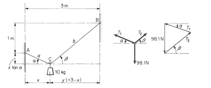

The ends of a cord length 3.5 m are attached to points A and B as shown in figure 3.2 a. A small smooth pulley carrying a body, mass m = 10 kg is placed on the cord and allowed to reach a point of equilibrium at C. Find the horizontal distance of this point from A and the tension in the cord.
(Basic Engineering Mechanics, J. H. Hughes and K. F. Martin)
N/A
My two questions:
  1. The author claims that ##T_1=T_2## and ##\alpha = \beta##, and this is supposed to be clear the force triangle. Why is this so?
  2. Is it possible to use calculus of variation to find the lowest point C? That is, by maximizing the triangle ABC (Area of ABC = ##\frac{1}{2}(line AB)(perpendicular of C to line AB)##), since by maximizing the perpendicular of C to line AB, we also minimize the height of the weight.
  3. How about finding the lowest point of an ellipse, with A and B as its foci?
P.S. I have not studied the calculus of variations, but if this is possible, then I might as well study it later.
1. The pulley is smooth (edit: or there would be a net torque on the pulley). This means that ##T_1 = T_2##. If ##T_1 = T_2## it is necessary that ##\alpha = \beta## for the horizontal forces to balance out.
2. It is not true that maximising the perpendicular necessarily minimises the height of the weight as the height where the perpendicular crosses AB varies.
3. That sounds like more trouble than what its worth.
Likes yucheng

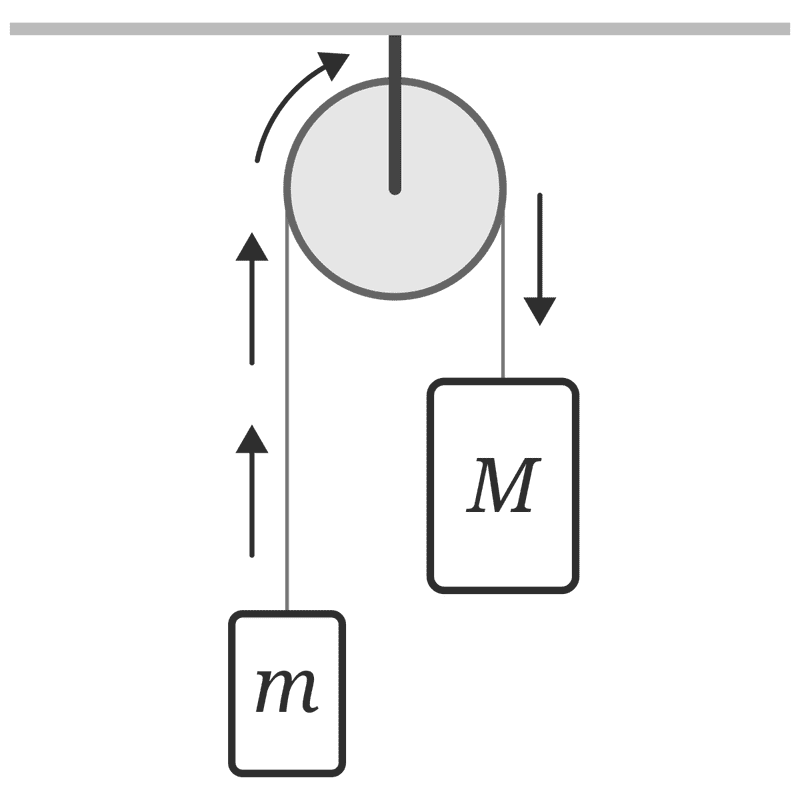

Oh wait, this problem is supposed to be similar in principle to this simple pulley? Literally invert the picture below?

Trying to respond your question #1 above:
The tension of the string is the same on both sides of the frictionless object that forces it to change its direction (pulley or hook).
For summation of forces in each of x-axis and y-axis to be zero, we should have a symmetrical geometry.
An isosceles triangle will form if you extend the portion of the string a until intersecting the horizontal line crossing B.

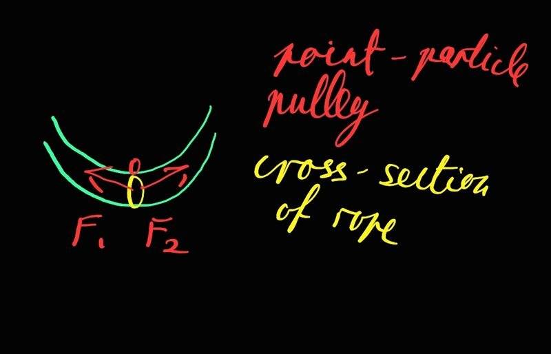

Hi Oroduin. Thinking about it, we're assuming that the pulley is a point particle. And it's smooth. So, how can there be a torque? Of course we still have the normal force acting on the pulley, by the rope.

By tension is the same, do you mean this (a cross section of the rope, forces i.e. tension acting on both sides of the cross section are equal in magnitude, at least locally. If we further assume massless rope, then it'll hold globally i.e. across the whole rope)
That is exactly the point @Orodruin made. There can be no torque, so the tensions each side are equal in magnitude .
Yes.
Yes you caught me on that, silly me; what I meant is that how is torque relevant here? Actuality, wait, @Orodruin mangroves (oops, mentions) that there is no resultant torque right? I.e. both forces give rise to torque, but they are in opposite directions and they cancel, but how do they give rise to torques that act on the pulley?
Normally, when we are told that a pulley is frictionless it means there is no friction at the axle. Generally one assumes rolling contact between the pulley and the rope. On that basis, the fact that the torques must balance can be used to prove the tensions are the same.
But the result is still true even if it's just a smooth ring on the rope instead of a pulley. If the tensions were unequal then some of the rope would slide through the ring to equalise them.
