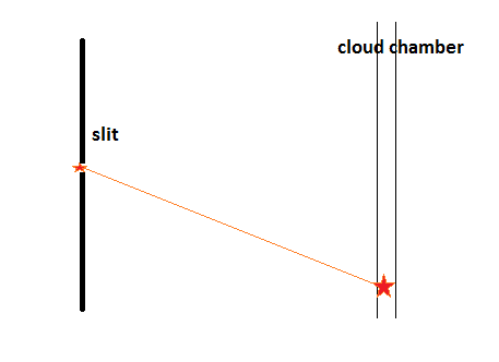

The following is kind of a semiclassical reasoning which goes along the style of the discussions between Bohr and Einstein in Solvay Conference.
Suppose we have a single slit from which a particle may be emitted and, on a very large distance from it, a thin cloud chamber CC, which we use as a kind of a screen to detect the particle.
Also suppose that we know the moment at which the particle passed via the slit (we can put some light source to fix that moment or we can use another small cloud area put at the slit so we could see a small bubble in the area of the slit when the particle passes).
As the particle travels from the slit to the CC, there is no force applied to it so it goes on the straight line with a constant speed and finally creates some bubble at the CC (the Cloud Chamber). We can calculate the speed of the particle as the distance from the slit to the point where the particle was detected at CC divided by the time between these two detections. By making the distance between the slit and the cloud chamber CC very big, we can reduce to any necessary minimum the contribution of all the uncertainties involved into the measurement of the speed as the size of the slit at which the first detection of the particle done, the size of the first bubble in CC at which the second detection done, the time measurement errors. Because we can reduce the error of the speed measurement to any minimum, so we can reduce to any minimum the momentum measurement. And the error in the coordinate measurement is determined by the size of the bubble it the CC. So in the end the product of the coordinate error and momentum error at the point at which the particle was detected at CC may be made (as it looks) arbitrary small which violates the Heisenberg uncertainty principle.
Could you help me to see where is the error in this reasoning?

Newton's first law doesn't apply literally in QM. If particles moved at constant speed in a straight line, you would know the position and momentum at all times.

Yet we can actually see a linear track in a Cloud Chamber (not in the experiment I am describing where the CC is very thin, but in a general experiment with a big thick CC). What I am doing it's like I am actually building a very long cloud chamber, putting some vapor at the point of the start and some vapor at the point of the arrival of the particle. Whatever quantum laws are, you cannot deny that the tracks in a cloud chamber are linear when no additional force is applied to the particle.

Here's the problem with your setup.
Suppose you place another bigger cloud chamber, twice as far from the slit as the first. If you were actually measuring the position and momentum of the particle to arbitrary accuracy, then once you saw the track in the first chamber you would be able to predict very precisely where to expect a track later in the second chamber. But what you will find is that it doesn't work: the particle will not hit the spot you predict. If you repeat the experiment many times, you will find that there is an inherent spread-out-ed-ness in where the particle will hit the second screen even after accounting for where it hit the first screen.
Basically you're doing an experiment and saying if the particle had a well-defined position and momentum, then given my results this is what they must be. The problem is that the particle doesn't actually have a sufficiently well-defined position and momentum, so it is incorrect to infer them the way you want to do from the experiment.
Likes PeroK and MichPod
The error in your reasoning is that the Heisenberg uncertainty principle describes a different situation than what you are describing. In the HUP, one has two identically prepared ensembles. On the first ensemble, one makes position measurements. On the second ensemble, one makes momentum measurements. The HUP governs [(variance in position measurements on the first ensemble) X (variance in momentum measurements on the second ensemble)].

Actually your post helped me much. I did not think of what will happen if I put another chamber... Thank you!

You asked where the mistake is. That has been answered multiple times. You are batting at something which is not the HUP.
As we showed you: Increasing the traversed distance, in and of itself, does not affect the uncertainty (measured as SD, per the HUP) at all. We have shown you that bubble chambers do NOT record the ending position of a particle at a discrete point in time. And we explained that you cannot prepare an ensemble of test cases in a suitable manner to arrive at a suitable starting point either - each test sample will be different!
To have this conversation with Bohr and Einstein, you'll need to ignore almost everything we're learned since 1935 (or 1927 depending on your perspective). Good luck, but you are really just ignoring what you are being told in favor of stating your own opinions. DrChinese out... :smile:
MichPod said:
I am trying to go along the same line of arguments which were between Bohr and Einstein in their very well known discussion in Solvay.
This is really a question of history, not physics. The physics has been sufficiently discussed.
