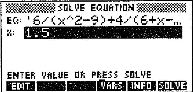

Calc Curious said:
By the way, I saw an earlier version of your post where you mentioned that the solve equation function of the HP 48G (the non polynomial one), requires you to graph the function and enter guesses, for it to be able to find other solutions. I'm confused as to how one would enter guesses, there doesn't seem to be a place to enter anything once the solver has found one solution.
On the 48GX, you can enter the value of x where you suspect a zero will be (see the attached image.) The arrows on the calculator can be used to move the cursor into this field, and then you can enter an initial guess value into this field before running the solver again.
Often, I start it at 1. If I want to look for other zeros, I might take a random guess.
Otherwise, I'd need a graph to better estimate what value to supply as a starting point for the solver; otherwise, it might converge to the wrong zero. The graph might be supplied ahead of time, or I might have drawn it with pencil and paper, or I could use the 48GX itself to draw a graph so I know approximately where the zeros will be.
The User Manuals for the 48GX and 50G are available online on the HP website. Perhaps browse through the 50G manual to see whether or not it has the functionality you want.
