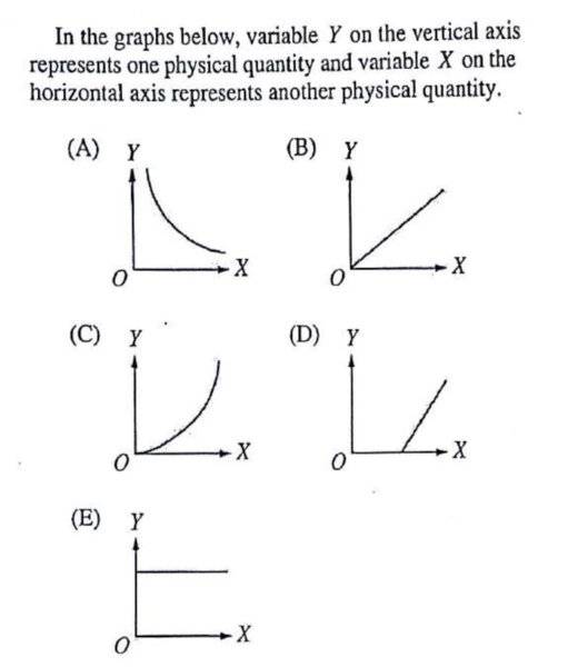

Which graph represents the Energy of a photon vs intensity?
In summary, the question asks which graph is correct when comparing X (intensity of monochromatic blue light) and Y (energy of each photon). The correct graph is the one with consistent energy in E, as increasing the intensity of light does not increase the energy of the photon but rather the number of photons. However, the photoelectrons are not relevant in this question, making the answer C incorrect. The answer should be E, despite the answer key stating otherwise.

If X represents the intensity of monochromatic blue light and Y represents the energy of each photon of the light, which one is the correct graph below?
KE=hƒ-∅, where ∅ is the work function
Energy of a photon= hƒ
Increasing the intensity of light does not increase the energy of the photon. However, It does increase the number of photons, which increases the number of ejected electrons (more current). Does that mean the graph is the one with consistent energy in E.

Since "Y represents the energy of each photon of the light," the photoelectrons have nothing to do with the question. The answer is indeed E.
Likes YMMMA
I don’t know why the answer key says it is C, so I had to check on my understanding.
