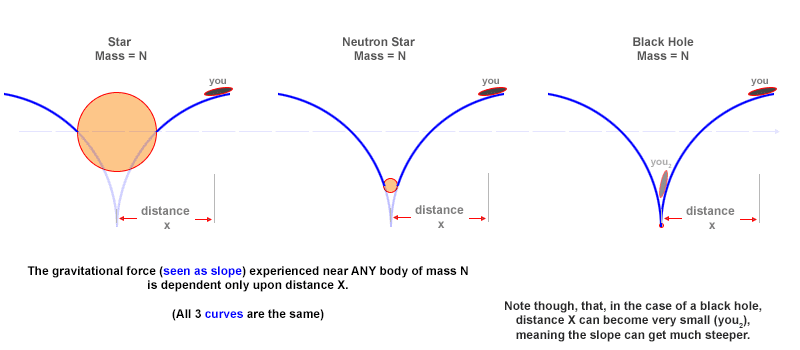

The strength of a gravitational field is determined solely by mass and distance from the center of gravity of an object. Oddities like the bending of light are only noticeable for compact [dense] objects. In such cases a light beam can pass close enough to encounter a region of severely curved spacetime. This does not happen for a normal density object. A light beam runs into the surface before it enters a region of severe curvature. The density of a black hole is so high it has a diameter of virtually zero, whereas a neutron star diameter is a little over a dozen kilometers. The diameter of an ordinary star is many thousands of kilometers.
Furthermore, at a fixed distance, the strength of the gravitational field is dependent ONLY on the mass.
i.e. if you had a black hole and a neutron star and a normal star that (somehow) all massed the same, the g-force at distance X from the centre of the mass would be identical in all three cases. If you were at a million clicks distance, and your spaceship had no windows, you would have a tough time telling which of the three you were orbiting.
The exterior solution of the Einstein's field equations are isomorphic in the two cases. Whether its a star, or a black hole, the metric and hence the 'force' or deflection of light rays is the same.
The only difference is that in the case of a stellar black hole, the actual mass of the central object is slightly greater than that of a Neutron star (its something like 3 stellar masses for a Neutron star, and greater than 4 stellar masses for a black hole). Of course you could imagine an eternal black hole with the same mass.
