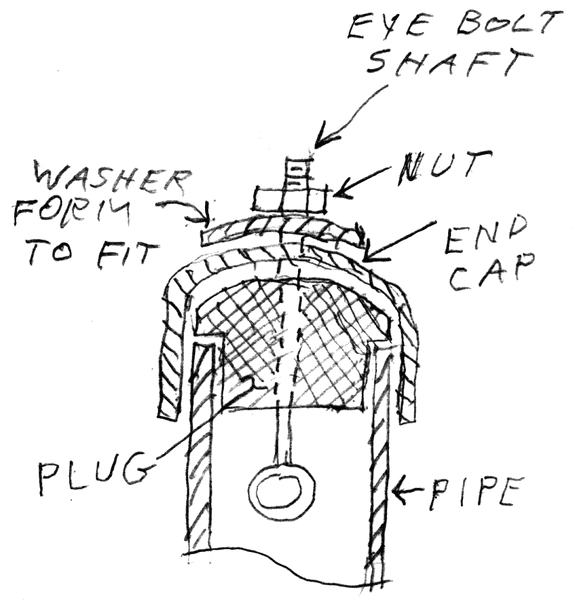

im attatching a bolt to the inside of a pvc endcap
i plan on having a metal plate on the outside so the connection is distributed over an area larger than the nut
my question is, reguarding strenght of connection, and integrity of endcap
is it better to go with a single hole (eye bolt) or 2 (u-bolt/cable clamp)
my worry is that an eye-bolt means all the preasure is centered in one spot
but a u-bolt means putting 2 holes in rather close proximity, meaning a potential weakspot

Alt-Bringer said:
but my main concern is wether i should use an eye bolt or a u-bolt
The above discussions assume a flat end cap. However, some end caps are convex, or domed. Any flat reinforcing plate or washer on a domed end cap will concentrate stress; either around the hole in, or around the periphery of, the end cap.
You don't say which direction the force is in relation to the pipe. i.e. pulling the cap off the pipe or pushing it onto the pipe. With a domed end cap, pushing onto the pipe, then a plug with a shoulder on it inserted into the pipe would be best. If a cap is still needed, shape the plug to the cap interior.
If pulling the cap off the pipe, then an insert in the cap, shaped to the cap interior is needed.
In either case, I vote eye bolt. That leaves more of the weak plastic available for structural strength. (It's also less machining.:smile:)

yeah, cap is convex, force pulling in

using washers, I am thinking i should peen them to fit the concave better (wide fender washer, both sides +rubber spacers)

Here is what I had in mind.
If the end cap is not needed for sealing, make the top of the plug flat and use a flat washer.
If the end cap is needed, then your idea of rubber washers inside and outside the endcap would be a definite improvement.
Don't rule out epoxy . JB-weld from Walmart has strength up to 3900 psi. Underneath @Tom.G 's washer it'd beef up the whole assembly. Get a fender washer big enough to cover the whole cap so it'll be in compression not shear.
