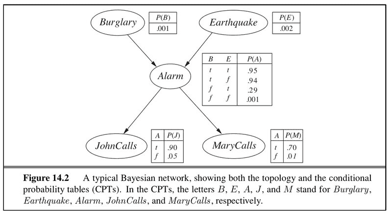

Which is the probability of JohnCalls given Burglary? Why?
In summary, the probability of JohnCalls given Burglary refers to the likelihood that John will call when a burglary occurs. This probability is influenced by various factors such as the relationship between John and the burglary event, prior experiences, and the overall context of the situation. Understanding this probability involves analyzing the connection between the occurrence of a burglary and John's response, taking into account any relevant data or patterns that may affect his likelihood to call.
alima
Bayes' Theorem = P (A|B) = ( P(B|A) * P(A) ) / P(B)
Questions:
  1. P (JohnCalls|Burglary) ?
  2. Why?
Source of the image: Artificial Intelligence: A Modern Approach - Third Edition, by Stuart Russell and Peter Norvig.
My attempt at solving: using Bayes' Theorem = P (A|B) = ( P(B|A) * P(A) ) / P(B)
P(JohnCalls|Burglary) = P(J|B) = ( P(B|J) * P(J) / P(B) )
  • P(B): 0.001
  • P(J): it depends on the Alarm ringing or not!
  • P(B|J): how I am supposed to deduce this???

What does the illustration represent, particularly the JohnCalls and MaryCalls parts? Is the idea that if there is a burglary or earthquake, then the alarm goes off, after which either John or Mary calls someone? This isn't clear to me from the drawing.
There is a formula for conditional probability that you don't show.
$$P(A | B) = \frac{P(A \cap B)}{P(B)}, \text{ if } P(B) \ne 0$$
Sorry for not being clear enough. Here is the description of the book in my own words:
  1. There is a house, and this house has an Alarm;
  2. The Alarm detects Burglary, but also sometimes respond to minor Earthquakes;
  3. John and Mary are neighbours of said house and will call you, the resident, if they hear the Alarm ringing;
  4. The neighbours are not 100% accurate. John sometimes thinks the telephone ring is the Alarm ring (false positive), and Mary does not always hear the Alarm because she likes to hear to loud music (false negative).

There is an important point that you need to notice. According to that diagram, the event of who calls is independent of whether the alarm is due to a burglary or an earthquake. Reversing that, whether the alarm was due to a burglary or an earthquake is independent of who calls. (Independence is reflexive or you can prove this with another application of Bayes Rule.) So P(B|J) = P(B).

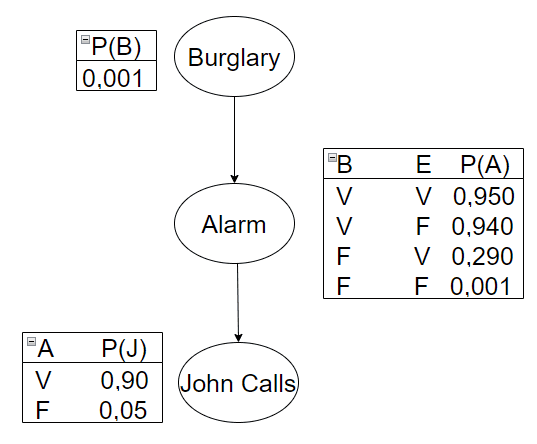

WAIT! I might have to think about this because I am assuming from the diagram the exact thing the problem is asking about.
  • Wow
Likes alima
That is totally correct.
The diagram can be simplified like that, right, since Earthquake isn't relevant to the question?

I don't know whether you can disregard earthquake events. P(A) = .95 if both burglary and earthquake are true, but P(A) = .94 if only a burglary event occurred. If we assume that event B (burglary) means that only a burglary has occurred, then the probability .94 seems appropriate. But we also have to consider that the alarm goes off with probability .001 even if no burglary has occurred.
Also, you have to consider that John calls 90% of the time when he hears the alarm, and also 5% of the time otherwise (like if the telephone rings but he thinks it's the alarm).

What we do have to consider though is the possibility that an earthquake has also occurred, making the probability that the alarm goes off 0.95 instead of 0.94. How can we account for this? Is the effect smaller than the precision appropriate to the problem?
You are right. I reincluded the Earthquake on my simplified diagram.
What else should I change?
Nothing, the diagram in the first post in this thread was already fine.
