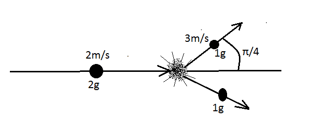

Hey! :o
If a particle of mass $m$ has velocity $v$, its momentum is $p=mv$.
In a game with balls, one ball of mass $2g$ springs with velocity $2m/s$, it hits two balls, both of which have mass $1g$, and stops.
The one ball get soared with velocity $3m/s$ and with angle $45^{\circ}$ to the direction that has the biggest ball at the moment of the crash, as is shown below.
Supposing that the total momentum is the same before and after the crash, I have to find with what angle and velocity the second ball will move.
I have done the following:
Let $(u,v)$ be the unit vector in the direction of the desired velocity.
Let $\theta$ is the desired angle. $(1,0)$ is the unit vector of the $x$-axis.
Then we have that $(u,v)\cdot (1,0)=\cos\theta \Rightarrow u=\cos\theta$.
Since the vector is unit, we have that $u^2+v^2=1 \Rightarrow v^2=1-u^2 \Rightarrow v^2=1-\cos^2\theta \Rightarrow v^2=\sin^2\theta \Rightarrow v=\pm \sin\theta$.
Since the desired vector shows to the negative $y$, we reject $v\sin \theta$, or not?
So, the unit vector is $(u,v)=(\cos \theta , -\sin \theta)$.
Therefore, the velocity vector that we are looking for is $v_2(\cos \theta , -\sin \theta)$, where $v_2$ is the magnitude of the velocity.
From the Momentum Conservation Principle at the $x$-axis we have the following:
$$4=3\cos \frac{\pi}{4}+v_2\cos\theta \Rightarrow v_2\cos\theta=4-3\frac{\sqrt{2}}{2} \tag 1$$
From the Momentum Conservation Principle at the $y$-axis we have the following:
$$0=3\sin \frac{\pi}{4}-v_2\sin\theta \Rightarrow v_2\sin\theta=3\frac{\sqrt{2}}{2} \tag 2$$
Therefore, $$v_2^2\cos^2\theta+v_2^2\sin^2\theta=16-12\sqrt{2}+\frac{9}{2}+\frac{9}{2}=25-12\sqrt{2} \Rightarrow v_2^2=25-12\sqrt{2} \\ \Rightarrow v_2=\pm \sqrt{25-12\sqrt{2}}$$
Is this correct so far? (Wondering)
Hey mathmari!
It looks fine to me. (Nod)
Furthermore, $v_2$ is a speed, which is the length of the vector.
That means it is non-negative. (Nerd)
Ah ok... Thanks a lot! (Smile)
