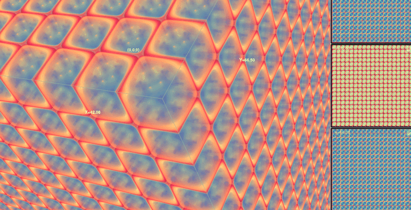

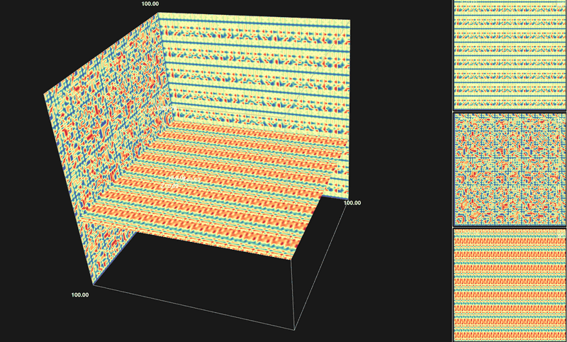

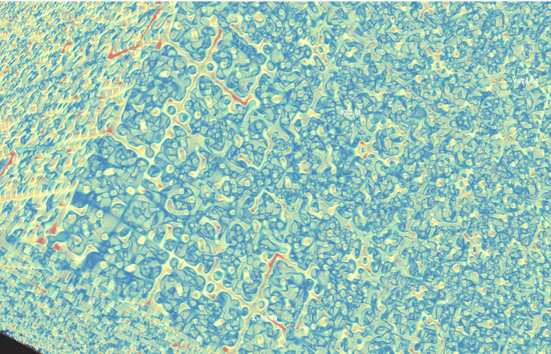

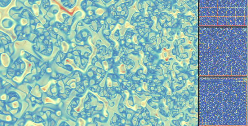

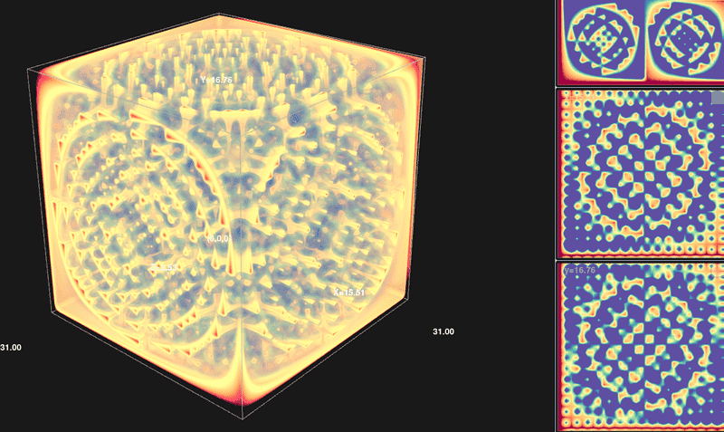

I'm curious how close someone could get to guessing the functions that generated the data shown below. And also, without looking at the plot, what do you think would be the most interesting looking function of x,y,z you can think of.
A)
B)
C)

They're each some functions that combine sinusoidal and the mod function.
It's pretty interesting to me the patterns the come from just taking the remainder.
Each of these are just fmod( i*j*k, r ) for different r.
