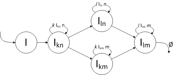

Oh I think I misunderstood the rules.
Now I found that the grammar generates the following strings:
[tex]I\rightarrow I_{kn}\rightarrow kI_{kn}n\rightarrow kI_{ln}n\rightarrow klI_{ln}nn\rightarrow klI_{lm}nn\rightarrow kllI_{lm}mnn\rightarrow kllmnn[/tex]
[tex]I\rightarrow _{kn}\rightarrow kI_{kn}n\rightarrow kI_{km}n\rightarrow kkI_{km}mn\rightarrow kkI_{lm}mn\rightarrow kklI_{lm}mmn\rightarrow kklmmn[/tex]
So is the language [tex]\{k^il^jm^in^j\}[/tex]? :confused:

Those look like correct words. ;)
But I don't think that is the language.
Let's try to visualize it:
Does that perhaps give you a clue what the words will look like?

Is it maybe [tex]\{k^il^jm^in^j:i,j>0\}[/tex] or is it something else? :confused:
Re: How to find a language generated by a given grammar
I'm afraid it's something else.
For starters, there are 2 paths through the graph, so you will get 2 possibilities.
Let's try the upper path.
When we leave state $I_{kn}$ we have $k^p I_{ln} n^p$, where $p$ could be $0$.
When leaving state $I_{ln}$, we have made it to $k^p l^q I_{lm} n^q n^p$.
When we finally leave $I_{lm}$ with $\varnothing$, we have $k^p l^q l^r m^r n^q n^p$.
So one of the 2 possible word sets is $\{ k^p l^{q+r} m^r n^{p+q} : p,q,r \in \mathbb Z_{\ge 0} \}$.

So,the other possible word set is: [tex] \{k^{p+q}l^{r}m^{r+q}n^{p}: p,q,r \in \mathbb Z_{\ge 0} \} [/tex] ?
Yep! :D

So,is the answer the languages [tex] \{k^{p+q}l^{r}m^{r+q}n^{p}: p,q,r \in \mathbb Z_{\ge 0} \} [/tex] and $\{ k^p l^{q+r} m^r n^{p+q} : p,q,r \in \mathbb Z_{\ge 0} \}$ ?
The language is the combination of the two:
$$\{k^{p+q}l^{r}m^{r+q}n^{p}: p,q,r \in \mathbb Z_{\ge 0} \} \cup \{ k^p l^{q+r} m^r n^{p+q} : p,q,r \in \mathbb Z_{\ge 0} \}$$
Or for short:
$$\{k^{p+q}l^{r}m^{r+q}n^{p},\quad k^p l^{q+r} m^r n^{p+q}\ :\ p,q,r \in \mathbb Z_{\ge 0} \}$$
