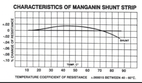

My initial schooling was practical in nature
Mr Davis (high school electronics teacher) taught us boys
'all resistors have some temperature coefficient. Carbon's happens to be negative so you will find that low-ohm carbon resistors actually decrease as they heat up. We know Ohm's law is the thinking tool describes ideal components, always remain aware that real ones are not quite ideal.'
So i never thought about definition of "law", ,, Ohm's is perhaps a ' thought tool' that goes by the name "Law" ?
Perhaps as teaching evolves it'll become "Ohm's Ratio"

You know i have a soapbox about the term "Ground"

sophiecentaur said:
But the point is that Constant Temperature is a very relevant factor in yer real Ohm's Law.
this is the best stuff i know of, 266 times better than copper
