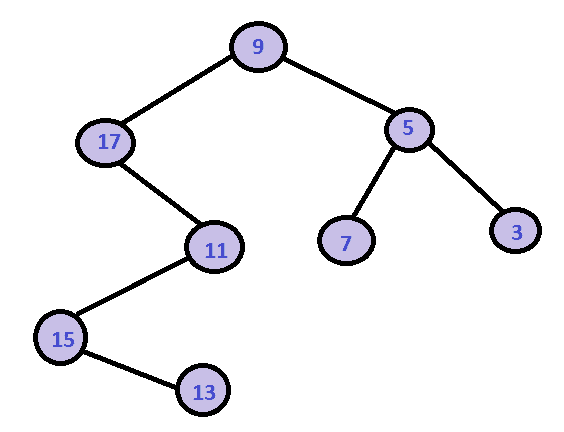

It is a given binary tree $T$, for each node $ n$ of which , all the keys of the nodes of the left subtree of $n$ are greater than the key of $n$ and all the keys of the nodes of the right subtree of $n$ are smaller than the key of $n$.
We suppose that $T$ contains the nodes $3,5,7,9,11,13,15,17$ and we are given that the pre-order traversal of the tree, gives as result the numbers in this row: $9,17,11,15,13,5,7,3$.
I have to draw the tree.
How can I find the first node $n$, which satisfies the first property? (Thinking)

Hey! (Happy)
A pre-order visits first the root of each node, then the left subtree (beginning with its root), and then the right subtree. (Nerd)
So we can already tell that $9$ is the root of the tree.
To which subtree will $17$ belong? (Wondering)

$17$ will definitely be a child of $9$.
What does the problem statement say about whether it should be left or right? (Wondering)
As for $11$, that comes later, but I don't think it can be a child of $9$. (Shake)

Since the keys of the nodes of the left subtree are greater than the key, does this mean that 17 is the left child of 9?
How can we find then the right child of 9? :confused:
What do we conclude then from the fact that 11 is at the third position of the pre-order? (Thinking)
Yes. (Nod)

I like Serena said:
Suppose we look at the tree:
Code:
17     11
What is then its pre-order? (Wondering)
It is 9,17,11, right? (Thinking)
Yep! (Nod)

Since $11$ is in the right sub tree of $9$, is it smaller? (Wondering)

How about:

So, the first number of the pre-order is always the root, right? (Thinking)
Then, do we know that the next two numbers are the children of the root?
Or do we know this only for the second one? Or for none of them? (Thinking)

Which of these satisfies the criteria of the problem statement? (Wondering)
This:
Code:
satisfies the criteria of the problem statement, right? (Thinking)

Yep! (Nod)
I like Serena said:
Yep! (Nod)
Nice! And 15 will be now the left child of 11? Or am I wrong? (Thinking)

evinda said:
So, will the tree be like that?
Yep! (Party)

Great! (Party) And this is the only tree, that can be found, right? (Thinking)
When you were building up the tree, did you have any choices to make? (Wondering)
No (Shake) So, it is the only possible tree, right? (Smile)
Yes! (Nod)
