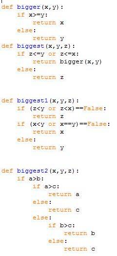

Since i don't know how to write code here on forums i will upload a picture and explain what's it about.
In the picture there are three codes that define the same procedure of finding the biggest number out of three given. The first code in the picture is defining a procedure called ##biggest(x,y,z)## and my friend and i agree that its the simplest one but it defines a procedure that is used in the given procedure to help the calculation. The second code is made by me and the third by my friend. We're kinda arguing whose is simpler and more elegant to use xD, what do you think?

I think if you only have 3 vars, it should be
biggest = max(max(x,y),z) or whatever construct is equivalent in whatever language you are using.
Likes Rx7man and doktorwho
Yeah i agree :-D, but the goal is to define a procedure and not use any built in, we are both beginners so that's why. We're using python :-D
Then use your bigger() function, following the idea that @phinds gave.
Python:
def biggest(x,y,z) : return x if x > y and x > z else y if y > z else z
If you're writing a function to find the maximum of more than two numbers as an exercise then you might as well make it work for any number of numbers.

Use your bigger function to define your biggest function:
Python:
def biggest(x,y,z):
    return bigger(x,bigger(y,z))
Likes jim mcnamara
Thanks i tried all and i think i like using the bigger function as i find it the simplest..:-)

Before I saw the Python label, I was thinking this (C):
#define biggest(x,y,z) ((x>y)?((x>z)?x:z):((y>z)?y:z))
I prefer biggest2, based on a performance point of view. With 2 comparisons you get your answer.
With biggest you need at least 3 comparisons, worst case scenario 4 comparisons (+ a function call).
With biggest1, you need at least 4 comparisons, worst case scenario 8 comparisons, before getting an answer!
