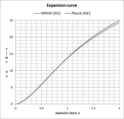

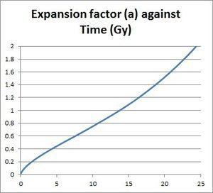

As an example of the kind of curves the above table contains here's the scale factor (a = 1/S) plotted against cosmic time. I'm using graphs Jorrie made earlier. Hope this is OK (tell me if not).
You can see the a(t) curve starts out convex (declining slope) and has an inflection point around year 7 billion. Then it becomes very gradually concave (increasing slope).
Here's a similar graph but flipped so the scale factor a is on the horizontal axis and time is on the vertical:
Again you can see the inflection point coming right around year 7 billion.
The a(t) curve can be thought of as the growth of a generic cosmic distance (separation between two CMB stationary observers) which has been normalized to equal 1 at the present time. In concrete terms, say, it is equal to 1 billion lightyears at this moment---or some other convenient unit. The growth of other cosmic-scale distances would be proportional---similar shaped curve.
Actually, the inflection point is a little later, around 7.6 Gy. It comes from solving the second Friedmann equation for [itex]\ddot{a}=0[/itex] (ignoring radiation):
[tex]a(t) = \left(\frac{\Omega_m}{2\Omega_\Lambda}\right)^\frac{1}{3}[/tex]
One can then find the time from the tabular calculator by setting the S = 1/a = 1.65 for the Planck values that Marcus used.
I will leave it to Marcus to convert the Lambdas to Hubble times. :wink:
