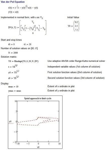

Do you require a symbolic solution to your ODEs or is a numeric solution sufficient? Most applications should be able to generate a numeric solution (I know Matlab and Mathematica can).
Another application to consider is Mathcad; it allows you to write many problems in near standard mathematical notation and plot the solution / inspect values on the same worksheet that you program. The first image below shows a simple ODE (Van der Pol) worksheet - define, solve, plot, all live and exactly as shown; changing a parameter results in the solution being updated and the plot updated accordingly. The second image shows a logistic map bifurcation generated by iteration.
You should be able to download or otherwise obtain trial versions of Mathcad and Mathematica.
