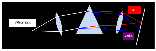

I think you are being mislead by the original Brittanica picture, which is wrong. They show the beam being split completely at the first face of the prism - as if the beam were as you conjecture - which is wrong.
(Edit: I've looked for some better pictures, but most fall into the same error. I think it is very hard to draw the correct picture, either by hand or with most graphics software.)
Say the original beam were 1mm wide, then the red light would come from the whole 1mm width and continue as a 1mm red beam producing 1mm wide band of red light on the screen.
Equally the blue light would come from the whole 1mm beam width in a 1mm beam all the way to the screen and produce a 1mm wide band of blue light.
Similarly for all the other colours - N.B. not just the nominal 7, but the infinite number of colour /wavelength gradations. Each produces its 1mm band on the screen, overlapping and mixing with the adjacent colours.
This effect can be reduced by making the initial beam narrower, which dims the spectrum or by using lenses to focus a divergent beam from a narrow slit, which keeps it brighter.

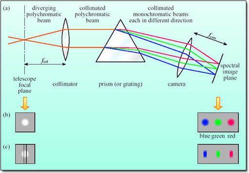

This is shown in SchoolPhysics . Their diagram shows only two representative rays at the sides of the beam, but you can see that both red and blue light (and all other colours) come from all parts of the beam.
Edit: Maybe a better diagram of the same thing at Telecopes in OpenEd
The "polychromatic beam" is the equivalent of the white beam, but what they are looking at may not be white. (If you try this experiment, it might be interesting to use an LED or flourescent lamp as a "white" source. Their spectra are noticeably different from that of sunlight or incandescent light, even with simple equipment. &BTW, if you want to experiment and haven't got a suitable prism, a CD will do an adequate job as a diffraction grating.)
Indeed. It's important to understand that the light being sent into the prism in most pictures is a thin beam or column. Without making the light into a beam or column you cannot see the dispersion. If you have a prism, cutting a thin rectangular slit in a piece of thick paper or cardboard should work just fine.
I see. So all the colors would be just as wide as the original white beam of light. Thanks everyone!
