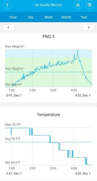

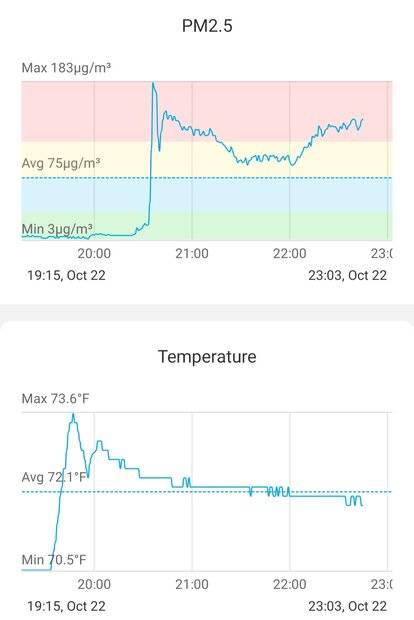

For additional context, I bought a PM2.5 detector (2.5 μm and larger particles) after the wildfires last summer. The results are interesting. (Maybe later we can discuss the hazards of gas cooking and microwave popcorn...). Among the results are poor air quality readings in my bedroom with my combination ultrasonic/evaporative humidifier on. This morning in a test it read 160 μg/m3, which is "unhealthy" According to the WHO. It reads in single digit precision and can read as low as 0-1 if the HVAC has been running a while or I'm using my air purifier. Now, of course not all particles are created equal, and this scale was invented to measure particulate air pollution, which is mainly a nasty carbon soot cocktail. But what about what this humidifier is putting out?
