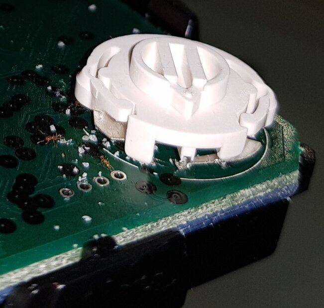

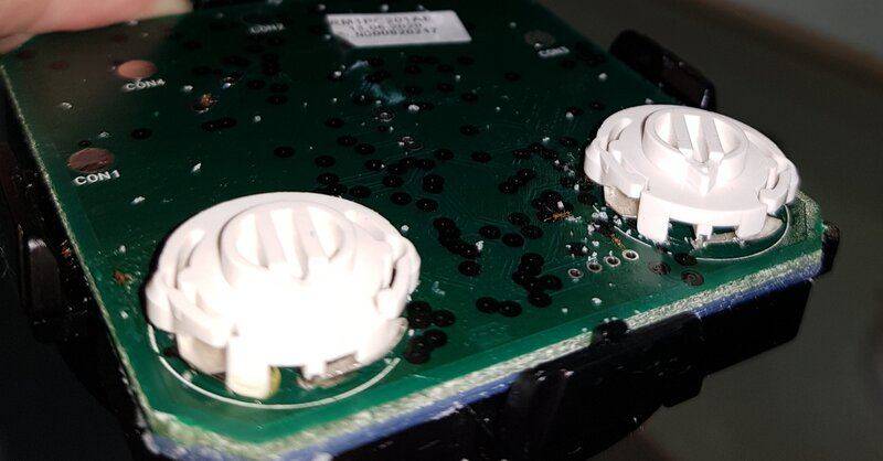

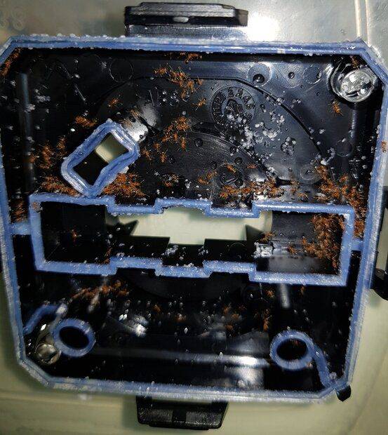

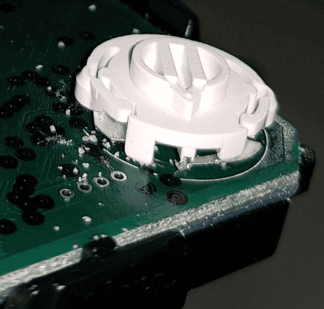

What is this white stuff in the ants colony inside electronics?
Is it sugar? nest?
I presume the ants were attracted to the warmth of the pcb?

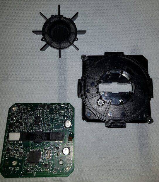

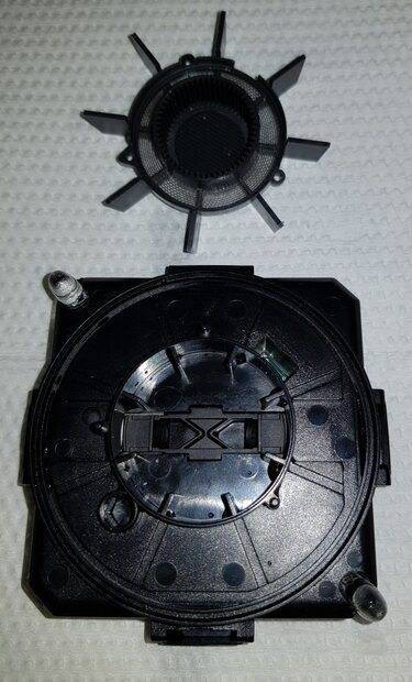

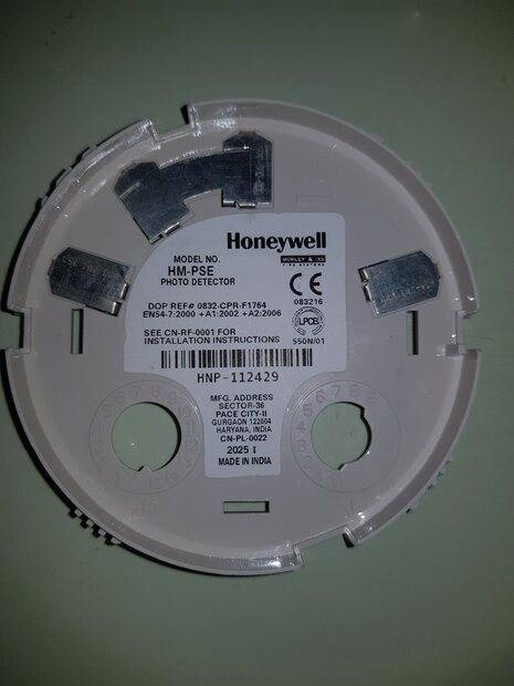

It's a Morley addressable smoke detector

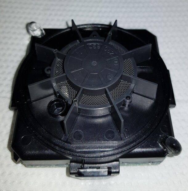

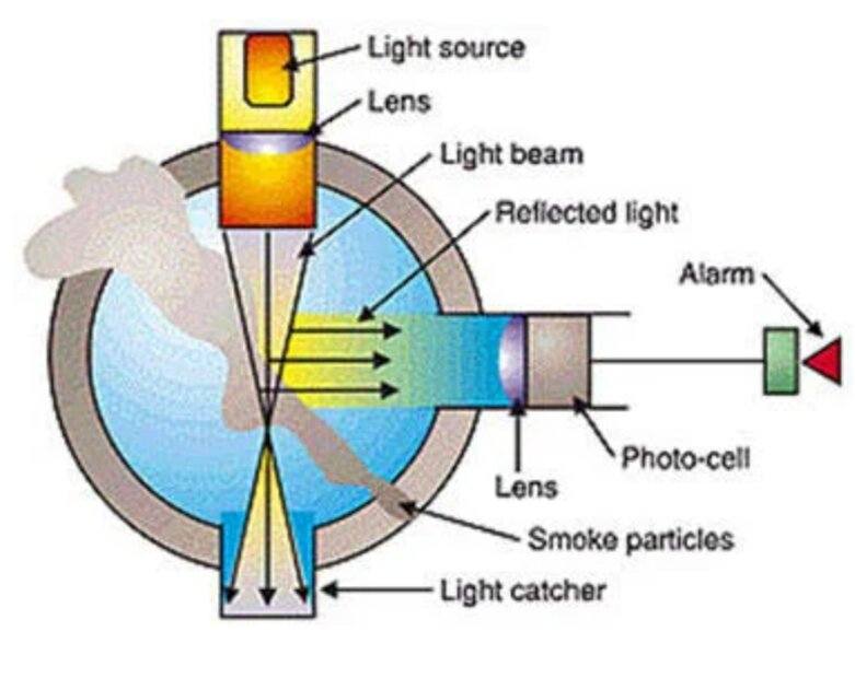

Separate question. I saw illustrations of a smoke detector with light catcher.
But the Morley doesn't have a light catcher. How does the light path work in this case? The right side is the led emitter, the left side is the detector. When smoke fills the chamber. It reflects light and turn on the detector.

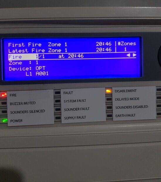

Oh, by the way, the reason I wrote the above thread was due to the fact the ants triggered the fire alarm. After resetting the alarm panel. It went off immediately and again and again. I replaced the fire detector unit thinking it was defective (the second one is ok). Then found out there was full of ants in all parts of it (the first original one). I think the ants acted as smokes that reflected the LED lights triggering the detector and fire alarm? How? The ants blocked the LEDs directly or paraded at the matte wall of the smoke chamber? Have you experienced it too?
The white stuff is likely eggs. Since you disturbed the nest, the ants will try to move them to a safe dark place.
With respect to the smoke detector, the Morley is a photoelectric type detector. Beyond that I can’t find any further info online.
It would seem a light catcher is only useful for determining if the LED emitter is working and to sound an alarm if not. So maybe the Morley has some other means of testing the sensor.

I'm pretty certain those are not eggs. Ant eggs are like tiny grains of rice. Those look like jagged bits of plastic.
I don't think it's likely ants did that (nor can I imagine what those ants are carrying them away), but it's conceivable that mice did by chewing.
Likes davenn
I was thinking the clumps may be two or more eggs stuck together. It's hard to tell with the photo.
The white plastic shell in the photo could possibly be styrofoam too which crumbles with age.

Which white stuff. The little bits that resemble grains of rice, or the big white thing that looks like it was machined?

Of course the little bits that resembled grains of rice. There were more of it before I washed the whole thing. The big white ones are addressable dials where you can set it from 1 to 99 (so you know what room or floor's smoke detector triggered).
I don't think it's chewed plastic. Nor styrofoam. Because there was no styrofoam in it. And the plastic was not damaged.
It happened to me once in a desktop computer keyboard. When I opened it, there was a colony of ants with the same white stuff. And the keyboard was black.
Is it food? sugar? egg? larvae? pupae? But these last 3 were supposed to be smooth, isn't it. Or maybe dried semen? or the ants feces?
