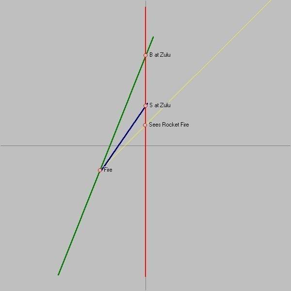

This spacetime diagram might help. It's in the Zulu frame of reference. Zulu sees the small rocket fired at the first event, the small rocket arrives at Zulu at the second event and the big rocket arrives at the third event.
The big rocket is traveling 0.4c. The small rocket is fired at 0.4c relative to the big rocket.

Ah, this is grand! JesseM, that was brilliantly explained, thank you very much!
I'm really grasping this now! :)
