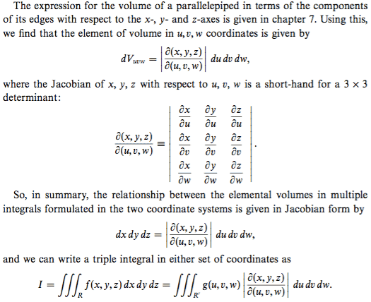

Hi JonnyG, thanks for your reply!
The book I'm reading justifies the change-of-variables theorem by assuming ##h## preserves volume. So if we use the theorem to prove its assumption, that is, ##h## preserves volume, we have a circular argument.
The change-of-variables theorem from the book:
The theorem can be, and usually is, proved without even mentioning isometries.
