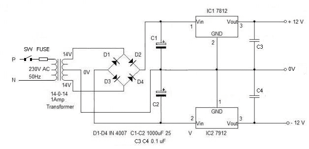

the negative, 0V and positive terminals of the DC output are isolated from ground
A 0V point doesn't have to be a grounded ( as in earthed point) it can still be isolated
eg ...
242266
Note the 0V rail s not earthed. This is pretty much the normal.
Your PSU will be the same except it uses a switching supply so that it can be made physically smallerDave

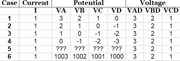

We may have a case of confusion between voltage and potential. I'll repeat a post from an earlier thread.
See if this helps.
In the pictures below, I show a simple circuit with 6 variations, moving the ground symbol around. In case 5, there is no ground; the whole circuit is floating. In the table of results, I show "potentials" each at a single point, and voltages each s measured between two points. The potentials are expressed relative to ground, but they could be expressed relative to any other reference.
In these examples, you can consider the ground symbol as either an imaginary reference point, or an actual physical connection to Earth.
The whole point is to show that the potentials and the zero reference point, are arbitrary and make no difference when calculating the voltage and current. Therefore, potential relative to infinity is a useful concept in physics teaching, when we get to actual circuits it is useless and we typically don't discuss it at all. There are exceptions, but those are advanced cases, not basic cases. We always try to understand the basic rule before the advanced exceptions.
Unfortunately, we sometimes get lazy and sloppy in our speech. Once the ground point in a circuit is decided and we start talking about voltages, we presume that the second wire of the voltmeter is attached to ground and start talking about voltage "VA" rather than "VA with respect to ground." In other words, using the language of potentials when discussing voltages. It is wrong but it happens every day.
Does that help or does it confuse more?
Likes EEristavi
