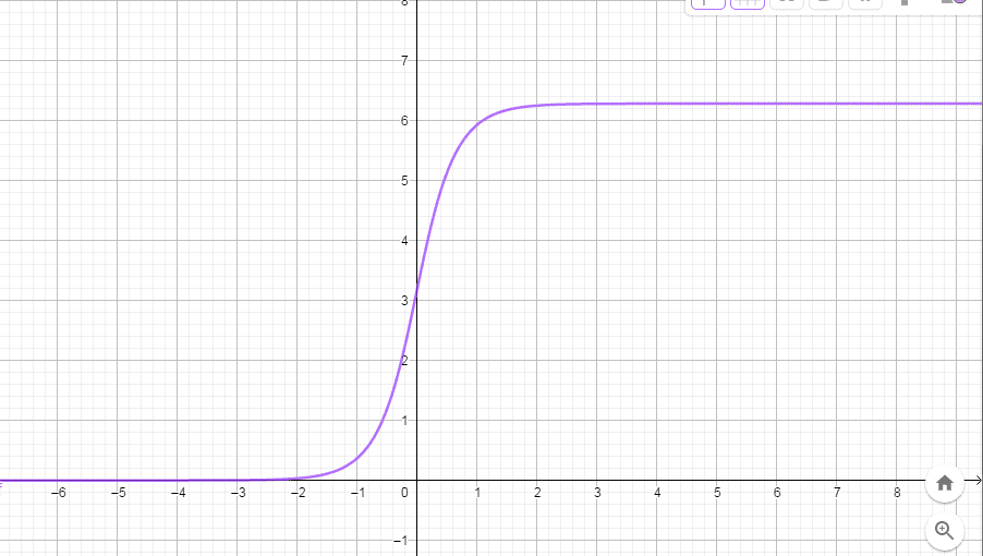

A particle slides on the surface of a fixed smooth sphere starting from the topmost point. Find the relation between the angle rotated by the particle as it slides down the particle.
I tried solving it using energy conservation.
I tried solving this, the equation coming up is given by: θ≈4 cot^(-1)(e^(-3.1305 sqrt(1/R) t)). However, this is not correct as can be seen when plotted: enter image description here
Can somebody please let me know, why is this equation not valid.?

I started by using this equation (by energy conservation): v^2 = 2gR(1-cos(theta)), where R is the radius of the sphere, and g = 9.8 m/sec^2.
Next equation I used is dv/dt =gSin(theta).
Solving both these equation gave this formula: θ≈4 cot^(-1)(e^(-3.1305 sqrt(1/R) t))
When I plotted, it, It seemed wrong.
I'm just trying to understand, what will be the correct relationship between theta and time.

This is exactly the differential equation that I figured out while I was attempting to solve it. On solving this equation, the equation I got was θ≈4 cot^(-1)(e^(-3.1305 sqrt(1/R) t)) , which I've posted in my original post. By plotting it in a mathematical software(Geogebra), what I saw, I've posted that too in my original post. But, the plot is not showing the behaviour that I was expecting. For eg, the graph crosses y axis(which is theta) at 3.14 radians, and becomes flat after a while. But the graph should have crossed at the origin. That would have made sense. That's why I asked in my original post, why the equation does not seem valid. I even considered that exactly t=0 (x axis being t), the equation will not be valid, but at every other point in time, it should be valid, but the graph becomes flat after a while, but the value at which the graph becomes almost flat makes no sense either(even after converting in degrees).

I was already aware when I was attempting it by myself, that at theta exactly =0, the equation will not not be solvable, because the particle will be in equilibrium, though unstable equilibrium. However, I used Wolfram alpha, to solve it. It gave the equation that I used to plot the graph.

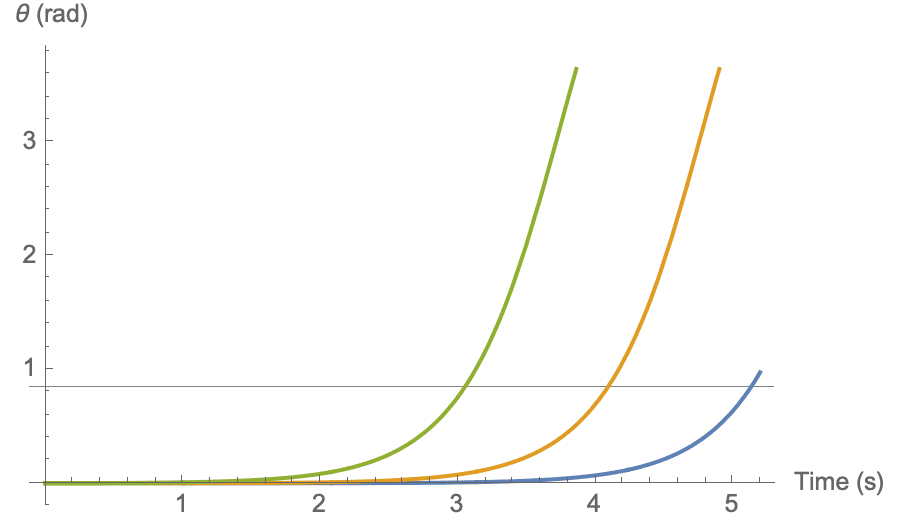

@Amit1011 you can solve the equation posted on #22 by @etothepi using the identity ##1-\cos\theta=2\sin^2(\frac{\theta}{2}).## That eliminates the radical. You will need a ##\theta_0## as the lower limit of the integral which you should be able to do. When I did all this, I was able to get ##\theta(t)## in closed form and plot it. You can get help to arrive at the equation that I got (it doesn't look like the one you posted in #1) and, if you post all your work, we can help pinpoint any errors that may have made. If you don't post your work, it will be difficult for us to help. It is also difficult for us to help you if you post a hybrid form of symbols and numbers such as "θ≈4 cot^(-1)(e^(-3.1305 sqrt(1/R) t))" If you put your equation in symbolic form, I will better be able to compare it with my equation which is also in symbolic form. It took me
Shown below is angle vs. time for three values of ##\theta_0##, 10-3 (green), 10-4 (brown) and 10-5 (blue). The gridline is at the angle where the mass sliedes off. You can see the trend as ##\theta_0## becomes smaller and why it is necessary to have a small but non-zero value for it. Note that 10-5 rad is quite small, the angle subtended by a meter stick 100 km away.
