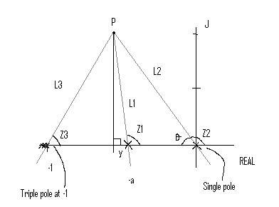

Hi,
I’ve been studying Root Loci for almost 3 months now, on and off, so I know most of the methods involved with it. I’m still pretty much new to the subject still as I’ve recently hit a problem with this exercise that I’ve been working on for the past 3 weeks, I’ve spent most of the last and this week literally stuck on this particular part, and it’s driving me crazy!
I can’t just leave the thing as I’ll always have the cravings to come back to finish the job, as my curiosity for finding the answer will only grow.
Can someone help me out and end this torture?
Question:
“A position control system has a block diagram as shown above.
The plant is controlled by a Compensator, Gc(s) and variable gain, K
The Specification for the whole system is:-”
1. The Steady State error for a step input is zero
2. the steady state error for a unit ramp input is less than 4
3. the percentage overshoot for a step input is less than 5%
4. the 2% settling time for a step input is less than 10 seconds
Design a compensator and determine K. Use the root locus point design method.
What I’ve done so far…
the Plant is: S²+2S²+2S+1
I figured that the system compensator, Gc = (S+a)/S

It seems correct to me. You know the real part of the dominant poles (0.391) and the angle θ, so you can obtain the imaginary part of the poles.
You know that if those poles belong to the root-locus, the sum of the angles from the poles minus the sum of the angles from the zeros of the open-loop function, must be an odd multiple of 180 degrees.
Your only unknown is the zero at -a.

To find the value ‘a’, Angle Criterion can be used by locating the pole, P, and the angles of the open loop poles and zeroes on the root locus diagram.
So, P = 0.391 +/- j0.3912tan (46.1239)
= 3.91 +/- j0.4068
‘a’ is placed at random
The Angle Criteria is argG0 = -180
Hence, α1-α2-3α3 = -180
Where α1 is the positive since pole zero and,
α2-3α3 is negative since pole
α2 and α3 can be determined exactly:
α2 = 180-θ = 180-46.1239
α2 = 133.8764
α3 = tan^-1(0.4068/0.6931) = 30.409
α3 = 91.229 – since triple pole.
α1 = -180=133.8764 + 91.229 = 45.106
And I’m looking for the angle opposite to this one, so:
α1 = 180 – 45.106 = 134.894
0.4068/y = tan134.894
so, y = 0.4068/tan(134.894) = -0.4053
Therefore ‘a’ = 0.4068—0.4053
‘a’ = 0.8121
‘a’ does looks like the right value, but I do like to hear another opinion, if any, from someone with a little more experience than me. Is this right?
-Kai-Itza-

Where did you get the triple pole at s = -1?
There is one pole at s = -1 and two conjugate poles at [tex]-\frac{1}{2}\pm j \frac {\sqrt{3}}{2}[/tex]

You must note that the root locus diagram I drew up in my last post was not exactly in scale, that one was a quick 5-min draw up to show what I’ve done so far.
As to your question, CEL, I’ve forgotten to place the transfer function of the plant as per stated from the exercise of which I’m working on and trying to figure out what I’ve missed/ screwed up in my calculations
The Plant described from the exercise is as follows:
Gp = 1/(s + 1)³
(In my earlier posts, I’ve broken it down where my thoughts meandered whilst working through this, my mistake!)
I’ll edit any posts where this has occured
As you can see from Gp, there are:
3 poles at s =-1 (as I got this from the Plant, Gp)

In your original post, you described the denominator of the plant as [tex]s^3+2s^2+2s+1[/tex], whose roots are the ones I pointed to.
