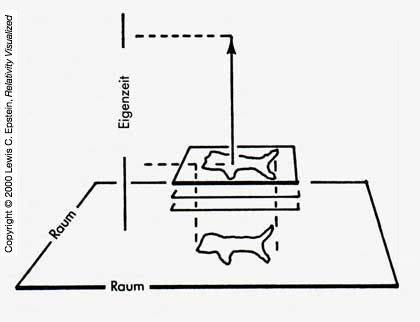

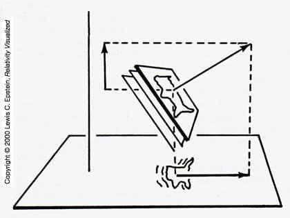

Some pedagogical / visualization related stuff:
- It shows the connection between velocity, time dilation and length contraction in a nice intuitive Euclidean way:
Raum : space
Eigenzeit : proper time
http://www.adamtoons.de/physics/relativity.swf
- The above diagrams could also be used to show geometrically how the clocks in the front & back of the rocked get desynchronized during acceleration
Albeit rather divorced from physics. Also incredibly misleading because it suggests physics is preserved by the rotation you use in the diagram.
Also, the key idea in the visualization is the projection onto the axes -- and that is present in ordinary space-time diagrams.

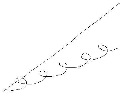

Just for fun, a rough sketch of one particle orbiting another, in [itex](x, y, \tau)[/itex] coordinates:
You forgot the axes, but it looks wrong anyway. The particle at rest has a worldline along the [itex]\tau[/itex] dimension. The orbiting particle has a helical worldline with the first one as axis. The path lengths of both are the same, so the helix ends at a lower [itex]\tau[/itex] coordinate.
I didn't choose [itex](x,y)[/itex] from an inertial reference frame where the central particle was at rest.
([itex]\tau[/itex] runs vertically in my diagram)
