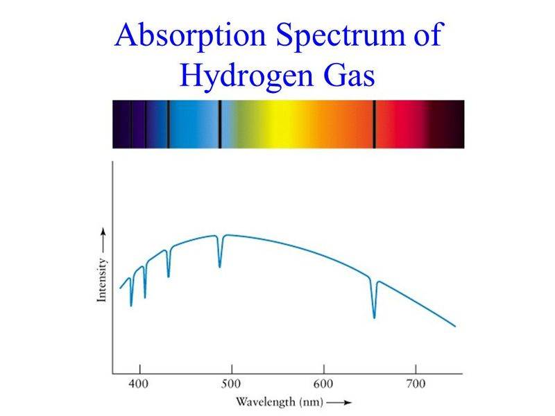

mfb said:
Gases usually have a discrete absorption spectrum.
Cardinalmont said:
Clearly a discrete absorption spectrum. The continuous spectrum is the spectrum being passed through the gas. The absorption is the missing wavelengths.
Likes Cardinalmont
Ahaha I can't believe I've been misunderstanding this for so many years! Thank you all for pointing this out. I find solace in knowing that my understanding of the physics was correct, just not my understanding of the image.
Likes sophiecentaur and (deleted member)
I believe this is one of those aha-moments :wink:
It is obvious once you know how to think about it but if you start with the wrong interpretation it can be difficult to drop it unless it is pointed out.
Likes dlgoff and Praveen Mani
Out past 700nm is lower than all five absorption lines. Does that mean it absorbs even more out past 700 nm?
I can't understand what you are implying here. The continuous spectrum is the spectrum of the source. The absorption lines are 'holes' in the source spectrum. They are only visible in the image where the original spectral level is high enough. There is much less energy at either ends of the black body radiation curve and the image just doesn't show it. With the right equipment, you could identify those lines too. IR absorption line spectra are 'a thing'.
No. It means that the source spectrum has a low intensity there. An absorption line is a discrete frequency where the medium the light is passing through absorbs the light.
