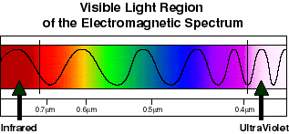

I thought red has a smaller wavelength than blue and therefore red has more energy than blue. So why is it that hotter flames glow with a blue color?
Likes Greg Bernhardt
A.T. said:
Hmmmmm
Apparently, you were misinformed.
