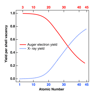

It seems pretty clear that when a core electron is ejected and another electron falls into that hole, it can either release that energy in a photon or in ejecting another electron. That makes plenty of sense to me. What I can't understand is why the percent chance of getting an x-ray vs. a Auger electron is dependent on the atomic number.
Any of you smart lovely people know the answer?
Danka,
Kathy
