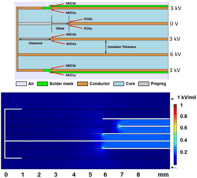

I've posted some images of different glass styles...photos credit to Isola. When you tell the board house your board specifications, if you do not specify the glass style they will use whatever is most convenient for them. The weave is typically larger glass styles for thicker cores and prepreg for larger thicknesses and heaver copper, unless you specify. Good luck getting them to use exactly what you want in the first place, but when you do it may also drive up the cost. The thing is, understanding the way different glass types "behave" may allow the transition from those more traditional high voltage components you suggested to something cheaper. Solid dielectrics in HV offer excellent performance. The problem is the quality of the solids. Voids in the dielectric itself, or the bonding layer, can significantly reduce their rating. PCBs have a very good process which produces pieces with a low voids. That is one of the reasons transitioning to a PCB for some HV components is of interest.
Going to the picture linked...the black represents the resin epoxy. The white area is the glass strands. Datasheets you look at specify a dielectric strength, dielectric constant, etc for the specific thickness of dielectric tested, specific glass style, etc. Understanding how these properties effect the materials performance for stuff like signal processing is well known as impedance control is crucial. The properties of the glass styles are typically combined to get just the right properties for high speed PCBs. I bet these have a big impact on HV boards too :smile:
I'm confused.

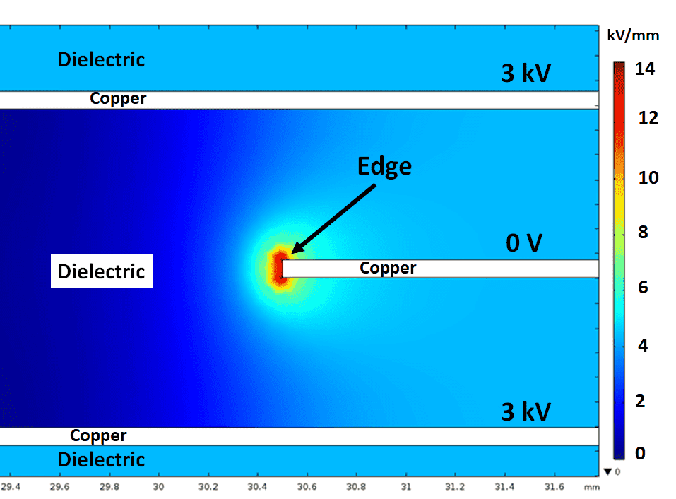

Sorry for the confusion. I've attached a new picture here with everything labeled. The voltages and spacing isn't necessarily important here as this is just to show a simplified example of what is really happening in the PCB in terms of e-field distribution.
This is an example of PCB cross section showing 3 internal layers. The two layers on the outside are at the same potential which is at 3 kV with respect to the inner layer. You can assume that the outer copper layers (3 kV) continue to the left, attaching to a via at some point. The middle layer (0 V) is pulled back due to clearance requirements from the 3 kV via. Finding the electric field with E=V/d assumes that you have parallel planes. That works great in the parallel plane region which is the area with uniform light blue as well as dark blue in the figure. However, when you look at the edge of the conductor, The e-field intensity goes from maybe ~5.5 kV/mm in parallel plane region to ~14 kV/mm. The only purpose of this was to illustrate that the e-field intensity at the conductor edges can be enhanced by a large factor.
As everyone above me has stated, considering the electric field in this way is not practical for every day designs, or "in real world" or "in real real engineering" as some here have put it.

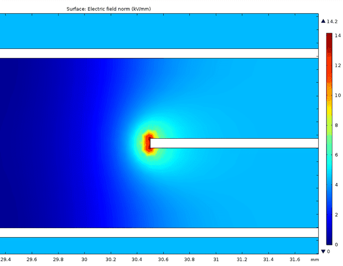

I'm using Comsol Multiphysics here. Really, it can be done in any software that can solve electrostatics problems. That would include Matlab as well, as long as you define the system. Using something like Comsol, Ansys Maxwell, or the like simplify the problem since you can easily define shapes then set your boundary conditions. You literally build the picture to represent a cross sectional (or 3D) view of your system. To solve the problem you need to define the material properties for each shape (copper, PCB dielectric, air, etc). You also set your boundary conditions...In other words, define the potential of each conductor. So just know that the conductors have a potential on them. It doesn't matter where its coming from, you're just defining the potential. Since I'm interested in an electrostatics e-field, defining current through them is not necessary.
I've attached a few more images zoomed out more to show what's going on. This is the cross sectional view of a PCB near the via. Since the via is round, I'm only showing the left half of the cross sectional view. It has axial symmetry so if you rotate this about the y-axis you will get the same results. Only simulating one section saves time and reduces computational resources required. The white areas are conductors. They are white because the e-field was not calculated in this region. There is no need to calculate the e-field here because as a perfect conductor the e-field within is 0. You can ignore the red arrows. They're simply used to label where the e-field intensity is highest for each layer.
The e-field enhancement at the corner of a conductor is normal. If you were laying out a trace, you wouldn't want to make it shaped like a V because the e-field intensity would be really high at the corner. Instead, you would make it U-shaped to smooth out the fields. You can't do that for the edges of a conductor like this in a PCB since you're simply etching away a thin copper foil. That leaves you with an edge at the end of the conductor has a field enhancement as shown.
Hopefully that helps.
