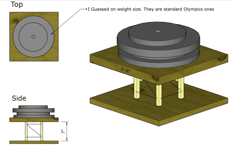

If I have four posts with a board on top, what is the optimal distance from the center to put them so they can support the most weight added on the board?
I have 4 tiny ~7in wooden posts that have cross bracing (let me know if I need to describe the bracing), and I place a solid wooden board on top of the posts then as much weight as possible on the board until the posts break. The posts are equidistant from the center of where the boards and weights are placed so the force is evenly distributed among them.
I am wondering where the optimal location to place the four posts is. (Ie far out to the corners of the board, like a table, somewhere in between, or no difference and I am wasting my time). For the purpose of this, I am assuming the weights are placed perfectly in the center of the four posts so I am interested in force/load (sorry, I forget the correct term) distribution based on distance for the center, not any torque or tipping of the “table”.
The posts will break long before any buckling, or the like, occurs in the board so I am assuming I don’t need to worry about that. I have considered just testing, but the materials are expensive so I was hoping for an general answer instead. Any mathematical reasoning is also appreciated.
I phrased the initial question referencing a table as that is essentially the setup, and I am assuming the same principles apply. However, I can’t visualize why so I was hoping someone could guide me through that. Thank you.

Do you have a rough diagram to show us?
Basic dimensions with a plan view will suffice.
Sorry, I still can’t imagine the centered donuts.
Hopefully the attached drawling is sufficient.
  • imageForPhysicsForum.pdf
I've taken the liberty of posting the OP's diagram directly. Hope that's OK, OP.
Likes russ_watters, DaveE and Quietrabbit

The answer you're looking for is "Put the posts along the square's diagonals, about 0.7x the radius of the average weight disk out from the center"
But, given the top looks pretty thick ; realistically it's best to put the posts at the corners : that way you'll avoid the posts working loose from incidental torquing in various directions.
Those steel plates, being the exterior diameter of the biggest one about 17.7 inches, are more rigid than the top board.
Because of that, it seems to me that those could be considered a distributed load, reducing the importance of the locations of the legs.
The weakest link seems to be the bracing of the legs: an X-type bracing is much stronger than any Z-type bracing.
Also, a central post could reduce the risk of placing a heavy plate too much out of the center of the board.
Indeed, the bracing as-diagrammed has almost no resistance to counterclockwise rotation, and will surely collapse immediately on its own - never mind adding weights.

Thank you for all the great feedback. I’ll be sure to change the cross bracing to an X(s).
The base has some other safety measures I didn’t include in the drawing for simplicity like a pole through all the weights so they don’t fall on someone.

As others have said, the vertical weight of the centered weights is not the real design load here. The real design load is weights dropped onto the table (impact loading), bumping into the top of the table from the side, weights dropped off center, plus general abuse. Any table in this application must be designed for loads much larger than just the weight of the weights, or it will be destroyed in a short time.
A better design, if made of wood, would be a box. The horizontal dimensions would be slightly smaller than the diameter of the weights in order to make is easy to grab hold of the weights. The top and bottom should be about 1.5" thick (2 X 12's are 1.5" thick). The sides could be plywood at least 0.5" thick if fitted to the top and bottom using rabbet joints (search the term). If rabbet joints are used, they should be used between each side piece, and between the sides and top and bottom. All joints to be carefully fitted and well glued.
Such a box will still be damaged by weights inadvertently dropped on it, so a piece of rubber on top would be a very good idea. The rubber should be at least 1/4" to 1/2" thick. Such a box will only weigh about 10 pounds.
