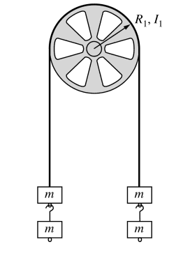

Check image attached
I have a hard time understanding why the F in T=FR is tension and not the weight of the blocks
Isn't weight the force that's making the disk rotate? I thought tension was just an opposing force.
T=Iα
Let the left string be T1 and the right string be T2. Pretend that the masses are NOT equal and that the total mass on the left is 3mg and the total mass on the right is 2mg.
My first thought: Net torque = 3mgR1-2mgR1
Actual solution: Net torque = (T1-T2)*R
Once again, the force that's used is tension and not the weight of the mass (which I'm assuming is what makes the system move). I just need some advice on understanding why that's the case.
That's not a bad first thought. But, are you sure it's your final answer?
That must be true, because only the string is attached to the wheel.
The mass difference is the cause of the motion, but you need to make sure that all the relevant equations are satisfied. For example, if ##T_1 = 3mg##, what does Newton's second law say about the motion of the ##3m## mass?

Your first guess tacitly assumes that the system is static and that will lead to the incorrect answer. Slow and steady solves the problem.

Try this. A block has mass =2kg and hangs from a string. Take g=10N/kg.
What is the tension when:
a) the block's acceleration is zero?
b) the block's acceleration is 3m/s² upwards?
c) the block's acceleration is 3m/s² downwards?
The forces directly acting on the wheel are the tensions. So in a non-equilibrium (unequal hanging masses) situation, you must use the values of the tensions, not the values of the weights.
This is a common error.
The disc is an inanimate object. Unlike you, it cannot see the source of the tension. It can only react to those forces that act directly on it.
Since the masses will move, there is a net force on them. Consequently their weights cannot equal the tension.
