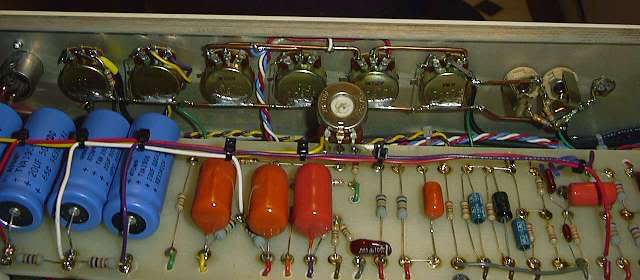

@OP, you have gotten some very good answers here. I have spend many days repairing, refurbishing, and restoring old guitar amps. Any place that the chassis could experience vibration, the wires were stranded (as were the power cords). The only place that one might expect to see solid copper busses were between potentiometers and ground (chassis). In fact, old Fender tube amps typically had very heavy uninsulated copper wires in such positions. Stranded wires were always used in power cords and in places where vibrations could stress the wires.

For reference, this a guitar amplifier built by a good friend of mine. He followed Leo Fender's rules pretty well. Use heavy copper buss connections along the potentiometers, jacks, etc. The thin solid leads to and from capacitors, resisters, etc were soldered to tag-board connecters, and all the connecting wiring under the board is stranded copper. This amp is bulletproof.
