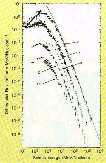

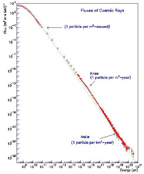

It helps to understand that a graph like the one below isn't only about the energy of individual protons of the Cosmic Rays but also what kind of particles it are:
"The actual particles that being observed as cosmic rays are thought to be protons and atomic nuclei (with ratios of each chemical species roughly reflecting the Galaxies own chemical abundances- ie. protons heavily dominant, followed by Helium nuclei, Carbon, Nitrogen, Oxygen and a fair amount of Iron nuclei). " link
Again this diagram cannot be seen as a whole, since at different energy scales you have different sources and so can have different components.
As for where it comes from, it comes from nuclei in general... that means protons, alpha particle, etc etc...however the proton is the over-dominant component .
Exaclty. Thanks.
Still I think I should change the "components" to "abundances" ...

Anyway the paper linked to by 'ChrisVer' showed a beautiful example / spike of a 100 TeV cosmic ray iron nucleus, a bunch of particles of which the individual protons have an energy of ~4 Tev that's in the same region as the LHC.
  • #31
Pouring a drop of some liquid into the ocean, you don't expect the interactions of other particles with that ocean to change... Just because you get a tail that spreads out doesn't change the composition of the atmospheric gases much... Again I find it a weird topic to discuss, since we are not that much interested into the target (what the cosmic rays strike), since most of those highly energetic strikes will lead to a hadronization (pions, Kaons etc) and so an electromagnetic shower (muons, electrons, gamma rays).
What we care about is identifying those showers and reconstructing the initial UHECR particle's characteristics. For example in the Cherenkov radiation method, they say that the Cherenkov radiation yield signal depends on the initial particle's atomic number squared ##Z^2##.

Again I am not sure, but I think that the iron nuclei don't appear at very large energies...
https://alteaspace.wordpress.com/2011/11/27/galactic-cosmic-rays-gcr/
I am talking about a figure as the second above. I am not sure if it's exceptional, but its flux is extremely small. Again I don't remember pretty well, but iron nuclei in cosmic rays, originate/are accelerated by supernovae, and so they have a threshold of energies they can reach. For the even higher energies we are not sure about the source mechanisms and there is a large literature dealing with different candidates.
