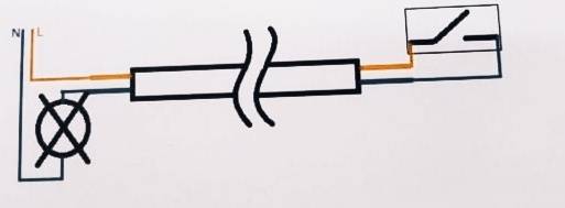

I have plot the circuit the best I could. The cable is 10 m long, and the two insulated wires have each one a section of 1.5 mm•mm.
Let's suppose there is no capacitance.
Changing the position of the bulbs is indifferent.

Coming right back to this, you seem to have drawn a bulb in series with a capacitor connected to the AC power. The switch is in parallel with the capacitor and supplies extra current when closed. But even without the switch a small current can flow via the capacitor, which might be enough to light the LEDs in the bulb all the time.
Even if the LEDs eventually go out, they may have been sustained by the charge on an internal capacitor. The external, wiring, capacitance would simply extend this period by allowing partial recharging of the internal capacitor.

I looked at 10m cable, 1mm diam wires, 2mm apart, PVC insulation and got about 1nF capacitance, for about 3MΩ impedance at 50 Hz and about 80uA current, neglecting the bulb impedance. A lot of 'about's in there and perhaps I shouldn't neglect the bulb's (complicated) impedance. Maybe I'll try putting 80uA through one and see if it glows dimly.
Power seems messy and I haven't worked out even a rough estimate. And I doubt a power meter would work at such low current.
