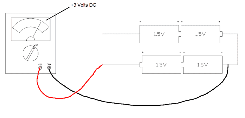

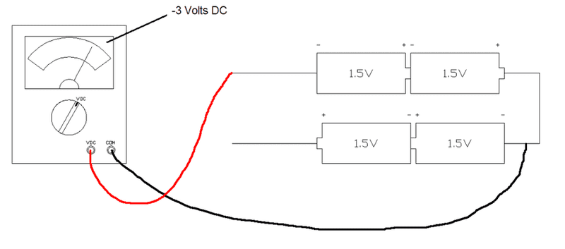

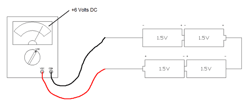

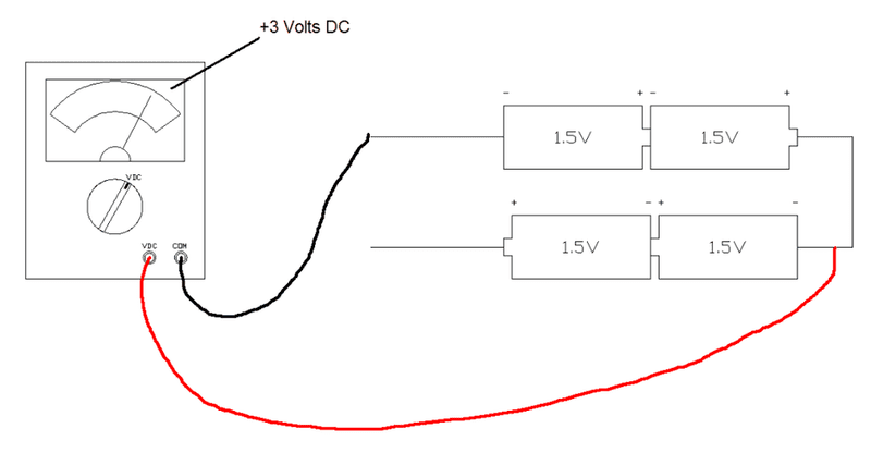

Here is another way to illustrate my point (hopefully the pictures will help):
If I have four D-Cell batteries connected in series like this:
and measure them with a voltmeter, I get 6 volts.
As you can see the batteries are all "in phase" with each other. That is, the direction of their polarity is consistent.
Now, if I reverse the meter leads like this:
the meter reads -6 volts. Did the voltage of the batteries change? No! I'm just looking at them differently; they are all still "in phase" with each other.
Now,if I measure from one end of the series-connected batteries to the middle connection (the center-tap) like this:
I now get a reading of 3 volts.
And, if I measure from the middle connection to the other end of the series-connected batteries like this:
I still get a reading of 3 volts.
However, if I now move my red (positive) probe back to the other end of the series-connected batteries, leaving the black (negative) probe at the middle connection like this:
I get a reading of -3 volts.
This is similar to how most people view a 240/120V 3-wire single-phase connection. The phasing (or, in the case of the DC batteries, the polarity) of any part of the system never reverses, only the way we choose to look at it does.
Just as the upper 2 batteries in my diagrams are always "in phase" with the lower 2 batteries, one half of a coil is always in phase with its other half.
