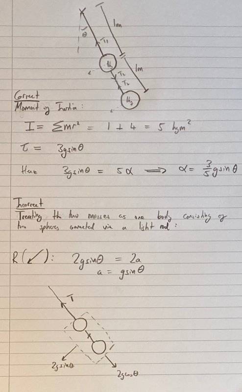

I did a quick scribble of a scenario which I think sums up my confusion. Two spheres connected via a light rod, with the top sphere attached to the hinge by a light string.
With the first method, I get an angular acceleration of ##\frac{3}{5}g\sin{\theta}##. If the centre of mass is at ##1.5m## from the pivot, its linear acceleration is ##0.9g\sin{\theta}##.
However, when treating the two spheres/rod as a system and applying Newton II I get a different answer.
A.T. said:
If your pendulum bob is an extended body that changes orientation, then the bob's attachment has to provide some torques around the bob's centre of mass. This can introduce tangential forces on the bob from the attachment.
Thank you, I'll have to think on it (just so I can clear things up for myself) for a little longer but that sounds correct!
So the extra external forces required for the rotation of the non point-like bob around the centre of mass also contribute to the linear acceleration. In the case of the scenario I just uploaded (sorry about the change, on second thoughts I thought the banana was a silly idea...), would we require an extra force to be added to the free body diagram at the connection between the string and upper sphere?
The details will depend on the type of pendulum. But I would start simpler than the double sphere. Even a single sphere on a string is messy enough: It doesn't keep its CoM on the line extending the string, allowing the string to produce a torque around the CoM. But this also means that the center of mass doesn't actually move on a prefect circular arc.

A.T. said:
start simpler
Still rather complicated. Wouldn't the rod pendulum be a better 'start simpler' candidate ?
Likes A.T. and etotheipi
Yes. Here the CoM moves on a perfect circle, but the force at the attachment is not always passing through the CoM, so it has a component parallel to the CoM's motion.

I'll have a go at analysing the rod pendulum now to see whereabouts the maths goes. Luckily the most important question in the thread has been really nicely answered (namely the origin of the discrepancy), which is attributed to contributions to the resultant force with components parallel to the direction of motion at the attachment. Thank you both for your patience!
