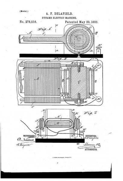

Probably it was done around 1880 when electrical machinery was the cutting edge of technology, have you tried searching on term concentric dynamo ?
My search engine turned up this patent from 1883, which i think is what you describe.
https://www.google.com/patents/US278516

Your response, while it may be correct, is a non-sequitur.
