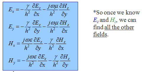

I don't think I communicated clearly. Look on that same wikipedia page under Analysis, it says -
"TEM modes (Transverse ElectroMagnetic) have no electric nor magnetic field in the direction of propagation."
This is due to -
If we sub in Ez and Hz = 0 (being transverse Electromagnetic Waves) then Ex = Hx = Ey = Hy = 0. And so there cannot exist a transverse electromagnetic wave in a perfectly conducting waveguide.
The only reason I can think of as to why we can see light going down metallic tubes is that it comes in at a slight angle, but I'm not by any means confident with this explanation.
And yet - clearly, there can - since EM waves go through waveguides all the time. Further, you know that this result is completely compatible with maxwells equations. It follows that you are misunderstanding them, or you are misunderstanding what you are being told when it is asserted that TEM modes are zero.
The requirement that the transverse amplitude is zero at the surface of the guide means that some wavelengths won't make it out the other end of the tube. Somewhere in your notes there should be a derivation of the EM field in a waveguide with conducting walls.
So what are you saying is wrong? Those formulas clearly show that EM waves propagating in z cannot exist - assuming perfectly conducting, propagation solely in z etc. etc.
It's correct that there are no TEM modes in waveguides with simply connected cross sections, but how do you come to the conclusion that no waves can go through it? There are many propagating TE and TM modes!
This is what I am saying is wrong - that is not what the formulas are saying. You are making a mistake. I'm trying to get you to elaborate on your reasoning so the nature of the misunderstanding will be exposed.
Of course you could just solve maxwels equations for the EM wave in a metal guide and see that you do, indeed, get waves out the end. But I suspect that won't clear up your confusion.

Yeah I know that Transverse Electric (TE) and TM modes can exist in these type of waveguides but I was under the impression light we see has to have an Electric and Magnetic component.
Does that mean that we can see EM waves with no M or no E field?
Edit: I should have been more clear, I meant "Those formulas clearly show that TEM waves..."

That reveals your misunderstanding! TE or TM just means that the component of the electric or magnetic field, respectively, in direction of the waveguide's axis (usually chosen as the [itex]z[/itex] axis of the coordinate system) is vanishing. Electromagnetic waves always have non-vanishing electric and magnetic fields. That's already clear from a very qualitative perspective on Maxwell's equations: If there is a time-dependent electric field there must be also a magnetic field and vice versa. Only static fields can be solely electric or magnetic.
