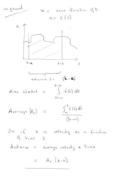

The way to derive an average for a non linear function (works for linear as well but is trivial) is to integrate the function and divide by the interval or number of points or samples.
So average = Area/Interval

Hello willem2 does this attachment help?
The average velocity is the number which if you multiplied it by the time would give you the total distance travelled.
