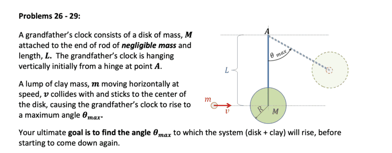

A grandfatherโ€™s clock consists of a disk of mass, ๐‘ด attached to the end of rod of negligible mass and length, ๐‘ณ. The grandfatherโ€™s clock is hanging vertically initially from a hinge at point ๐‘จ.
A lump of clay mass, ๐’Ž moving horizontally at speed, ๐’— collides with and sticks to the center of the disk, causing the grandfatherโ€™s clock to rise to a maximum angle ๐œฝ๐’Ž๐’‚๐’™.
Which of the following is an expression for the angular speed angular speed, ๐Ž of the grandfather's clock (with a lump of clay sticking to center of disk) just after the collision? [Note: Assume that the clay is a point mass. Moment of inertia of disk about axis through center of disk I_disk=1/2MR^2]

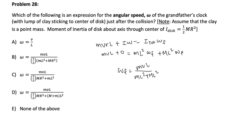

Since the question made no indication of the disk rotating about its center, I just straight up assumed that the disk did not rotate about its center, and instead treated it as a point mass. However, to my surprise my calculations did not bear me any fruit. Below is my first attempt at the solution, where you could clearly see that my calculations did not yield me an answer that's even remotely close as to what was offered in the MCQ.

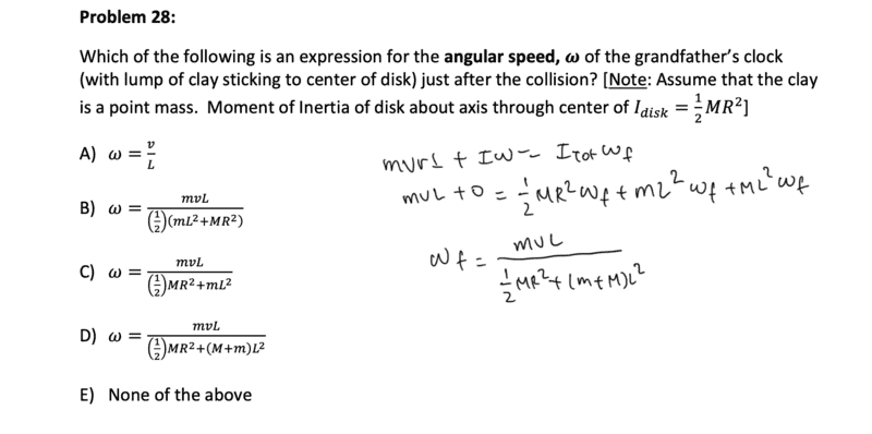

If I treated the disk to have rotated around its center however, I would get D as an answer. Below is my second attempt at the solution

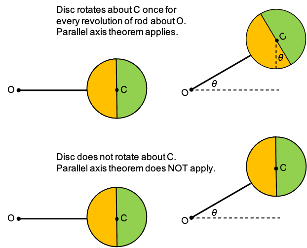

Yes. I think you are supposed to assume that the disk is attached to the rod so that the disk doesn't rotate relative to the rod.
Suppose you paint an orange line on the disk.
You can see how the disk rotates through some angle ##\phi## as the rod swings through an angle ##\theta##. What is the relation between ##\theta## and ##\phi##?
Likes mfb, MatinSAR, PeroK and 2 others
Here is a figure that I posted in another thread where the same issue arose. The Moon showing the same side to the Earth is an illustration of this idea of one spin revolution per orbit revolution.
Likes cory21 and Lnewqban
What surprised me about this scenario is that having the bob attached rigidly to the shaft, rather than on a free axle, increases the energy loss in the impact.
