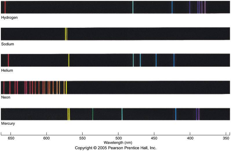

i was working with a spectrometer and the aim of the experiment was to find the refractive index of a prism for various colors.
i was asked specifically to use mercury vapor lamp and was insisted not to use sodium vapour lamp.
why is it so?
harini_5 said:
for various colors.
How many colors are in a Na vapor lamp?
How many in an Hg
And the ones you can't see in Hg can be a eye safety concern. i.e. Ultraviolet.
Hopefully precautions are being taken.
How many in an Hg
sir can u please tell me the difference between the two spectra,interms of colors etc?
http://physics.uoregon.edu/~jimbrau/astr122/Notes/Chapter3_4.html"
A wonderful illustration of why mercury is preferable to sodium.
